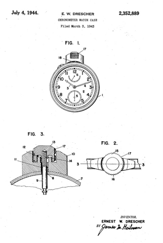

I was reading some past topics here on the site re: Un-gimballed (Cased) model 22's. My questions are (1) How many types of the base metal cases were made and used for the model 22's?. I see the Drescher Chronometer Watch Case patent that was filed on 03-03-1943 but I also see Keystone base metal cases, are they the same?.
and (2)If the cases were patented in 1943 would my circa 1942 mod 22 be inappropriate for such a case since the movement was made before the case was patented ?.

Tom BrownRay this is just a guess on my part, but I believe articles were put into production at times before the patents were actually filed for with the government, even more so during a war.
Looking at he patent the design looks identical to my Keystone case, I think that Drescher designed it but it was filed for Hamilton & then Keystone made it.
Thats just my thoughts, anyone else?

Matthew E. SuttonTom, I agree with you, I think that the patent design was after Keystone production. In fact I'm sure of it. The patent was awarded to Ernest W. Drescher, a Design Engineer at Hamilton Watch Company. Mr. Drescher also designed and patent a center seconds hand, hacking mechanism for the Hamilton 987S wristwatch.
In 1942, Hamilton started shipping both the gimbaled and un-gimbaled versions of the model 22. In 1948, the un-gimbaled version was withdrawn from service and sold as surplus, or given to other government agencies. Many were remarked on the case back to indicate service with the U.S. Army Transportation Corps.

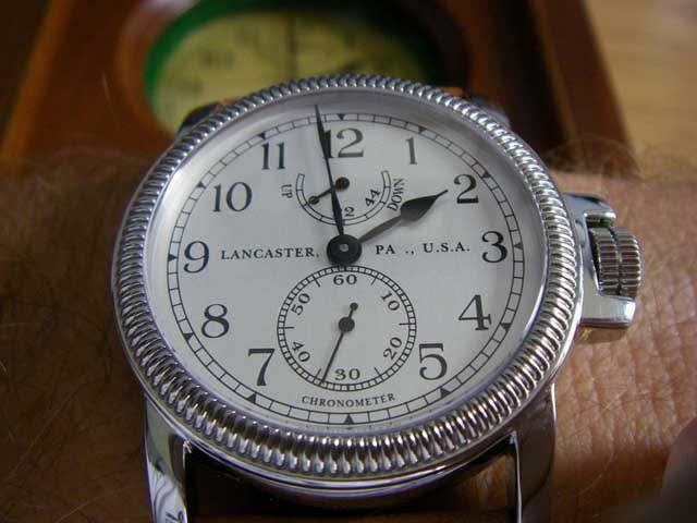

Matthew E. SuttonHamilton model 22 style wristwatch
December 27, 2009, 01:55
Ray HallenbeckWow, what a beauty
