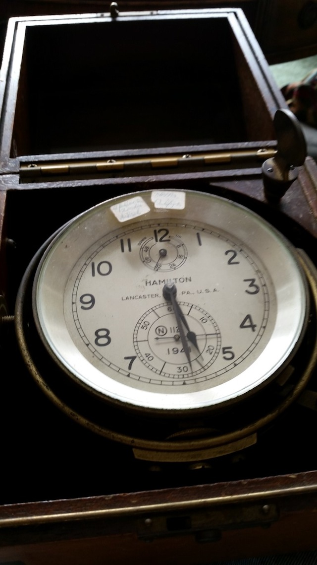

The piece itself is a Hamilton Model 21. It's in a gimbal box, and it seems the lower part of the box belonged with it, and the upper part was sourced separately (more about why I know this later on, my uncle collected quite a lot of things and he might have had the lid already or maybe he bought one after acquiring the Hamilton, I don't know)

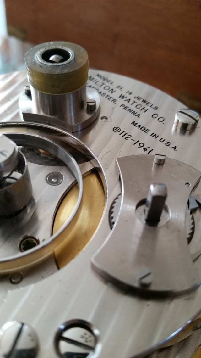

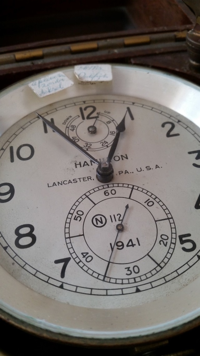

The serial number on it is N112, both on the dial and the mechanic itself. It was uncorked, and it doesn't have a balance lock. Fortunately, I wound it when we found it, and it worked, and we transported it while it was running. It's been running for over a day now, accurately. I do intend to cork it, since I have no clue about when it was last serviced.
There are no papers with it, but it has 2 small handwritten, same handwriting, stickers on the glass that give a little sight into the history of it.
The first sticker says Hr Ms Dolfijn, which indicates a Dutch naval vessel. More specific, a submarine. There have been three of these, the last one is still in service, so it is pretty certain to indicate either the first or second one.
The first Hr Ms Dolfijn was a British U-class submarine (original P 47) which first sailed in 1942 and was decommissioned in 1952. The second one was built in Holland, and was in service from 1960 till 1982.
The second sticker says "Afleveren zonder deksel" which translates to "Deliver without lid".
So most likely these stickers were put on when it was either sold or auctioned to indicate the origin and a remark about it not having the original lid for the box.

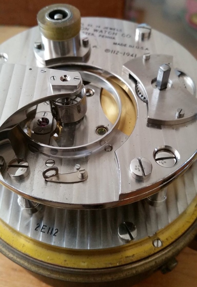

Now that I have posted the pictures, I am looking at picture 4 and notice a part that has been added at some point and looks like a mechanic to actually block the balance. One would still have to open the movement (as opposed to the one which looks like a Y and was used by the US service)

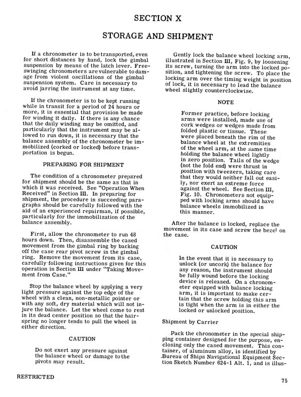

You were the fortunate recipient of a very fine chronometer. The arm which you noted in picture 4 is the lock for the balance wheel and was added during some of the chronometer servicing. It eliminates the need to cork the balance wheel. I have attached a couple pages from the Model 21 Service Manual NAVSHIPS 250-624. The first shows the locking arm and the second describes the correct method for stopping the balance wheel and putting the arm in the locked position.

Stopping the balance wheel
21 Bal wheel stopping

Thank you very much for the information Robert. So it seems there have been 2 upgrades made to the model 21 to add a locking device. The one that is in mine and illustrated in the service manual pages you attached, and the fork mechanism I noticed on other ones.
It is a very nice piece, it's still running to the dot at the moment. I'll go ahead and block it once it has run down the 48 hours.
