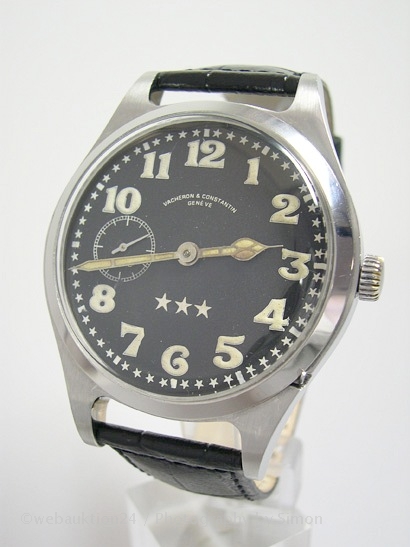

I followed a very interesting ebay auction recently. Wonderful Vacheron chronometer grade pocket watch movement with a black dial as a avigator wrist watch with complete us military markings selling for EUR 2500 bidder history... of course protected. now the first thing i noticed was the incapability to spell aviator. surely this would not have happened to the war department. seconly the case seems brand new. thirdly pocket watch wristwatches are always suspicious,..... why stars on the dial etc. If it looks to good to be true it generally is. hope the poor sucker never finds out and remains happy with this phantasy piece. and as far as i remember it does not have the hack functionality either?

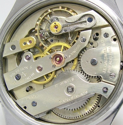

Glyn MeredithBefore you completely trash this watch Oliver, you might consider this.
J.E. Caldwell & Co. of Philadephia retailed jewelry, silver, watches and the like in Phildadephia from c. 1848 until the middle of the last century. They consistently contracted movements from Patek, V & C, and other top-class watch manufacturers. Sometimes Caldwells would co-sign the movements, sometimes they signed the dials, and sometimes the name of the manufacturer would appear on the dials. One reason why a jeweler such as Caldwell might sign the dial on top-class watches they sold was to avoid paying some sort of sales tax on imports.
Caldwell V&Cs are highly collectable, (see pic of 1920s example below) with many watches going for $3,000 and more (some less, of course).
I would estimate that this watch, being a contract from the Army Air Corps (established in 1926 and remaining thus named until 1935) did not attract that sales tax, since it was a government contract. For that reason, I’m not surprised to see the V & C signature on the dial.
Concerning “Avigator”, you might take a look at some Longines watches that are described with this word (blending ‘aviator’ or ‘aerial’ and ‘navigator’). Think Charles Lindberg for example. Although it looks like a mis-spelling, it isn’t. This word has been around since the 1920s at least, when it was used to describe the navigator in airplane races.
Take a look at the movement on the watch that you mention. The V & C serial # number would put the production of this movement at around 1916, just as the auction claims. The J.E. Caldwell signature is there. This watch could have been part of a military contract any time after 1916 – even some 10 years or more later, which would fit nicely with the first appearance of the word “avigator”.
I’m not sure why the dial would be marked with three stars, except that the five-pointed star has long and strong strong U.S. military connections - in the Confederate army, colonels wore an insignia of three stars, but I don’t think that would be a particular connection on this watch <lol>.
You wrote that “the case seems brand new”. I don’t believe this detracts from the authenticity of the watch. Some time pieces from the 1920s are still in pristine condition, as many on IHC will verify.
I’m not sure why you are suspicious of “pocket watch wrist watches” … this is a wrist watch, pure and simple … not uncommon in the 1920s/30s. … or are you referring to the classification in the auction? ... or the position of the seconds chapter at 9 o'clock?

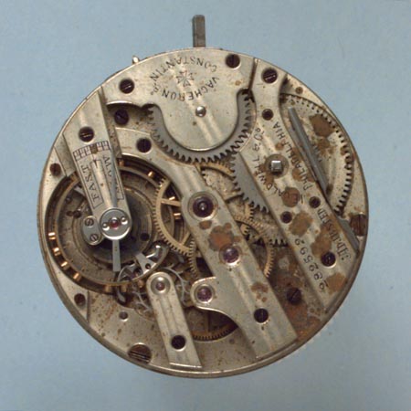

Glyn MeredithHere is a Caldwell V&C movement that seems to date back to around 1902. I've seen somewhere that J.E. Caldwell were putting their name on V&Cs earlier than that ... maybe as early as 1890.

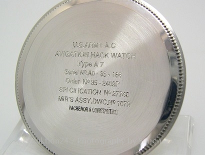

Jim HesterWhether the V&C movement by itself is worth the amount it sold for is a question I leave to others as I am not an expert on them, however, the seller in this auction was either unaware or purposely lying (I always try to thing people are the former though when people go to the effort to hide bidders names it always puts a doubt in my mind that they could be the latter) when he or she claimed that it is a WW I vintage military avigation watch. In his/her description the seller writes:
"RARITÄT ! Seltene Vacheron & Constantin "Avigation Hack Watch"
Flieger Herrenuhr der amerikanischen Streitkräfte
im 1. Weltkrieg von 1916"
The data on the case back shows that the case, at least, does not date to 1916. The order numbers show that it is a Type A-7 ordered by the Army Air Corps in 1935 which means it would have been delivered to the Army Air Corps sometime around 1935 or within a couple of years afterwards.
The Army Air Corps was created in 1926 and lasted until 1941 when it was renamed the Army Air Force. This means that there is a circa 1916 movement that was imported by a fancy Philadelphia jewelry store in a circa 1937/38 case that was provided to the U.S. Army under a large contract. I agree with Oliver that this just doesn't make any sense - it appears to me to be a franken-watch.

Glyn MeredithOK ... I'm beginining to feel uncomfortable about the case. No case screws and no case-screw marks. How did the hack get in there? ... there are no detailed pics of the lever slot, although on one pic it seems to be fairly professionally done.

Well, although I'm not an expert as Oliver clearly is, here are a few observations...
The case is without question a recent, shall we say RE-creation designed to fool the unwary and evidently it did. I agree the information on the back is a bit mixed up at best.
On the first line, No space between U.S. and ARMY along with no period after C to show an abbreviation. It was "U.S ARMY A.C." when done correctly. This one is not.
Second line, should be "AVIATION" and the "G" does not belong there. Also, with lever-setting, I agree with Oliver this is probably NOT a "HACK WATCH" as we see stamped there.
I'll not comment on lines 3, 4 and 5 as I know nothing about the specific (alleged) order.
Now to line 6 where the correct word SPECIFICATION is garbled to read SPI CII ICATION" which has no meaning in any language!
Line 7 we find MIR'S when they meant to have MFR'S at the beginning of the line.
Garbled information and misspellings give away the true intent...April 20, 2005, 12:33
Now, I'll comment on one place on the dial. It too looks like something recent and not much better than the case-back. Does anyone really believe that Vacheron or any other Swiss maker would print "GENE VE" rather than "GENEVE" on the dial? The three big stars and the silly looking stars at every minute are the last thing you'd find on a no-nonsense military dial.
Garish looking dial does not even resemble a military issue dial...April 20, 2005, 12:34

Phantasy? You bet, someone has sold an oddly put together assembly of unrelated parts and a recently done dial and case. Frankly for all the reasons stated above and more, it's not even a good fake. If someone did this for their own amusement that's one thing. Misrepresenting it in a world-wide venue is quite another!
Government contract with a retail jeweler does not make sense...

Why do you think 'Avigation'should not have the G, when 'avigator' and 'avigation' was an established word by the 1920s? I agree, it looks a bit strange though.
If the E and F of whatever made this lettering were not functioning properly, they could have printed as more like an I. This is consistent with the way SPI CII CATION and MIR have been printed. (But is that a stamp? It looks more like engraving to me)
The VACHERON & CONSTANTIN lettering is in a different point/size, so that theory does not apply to that line, which I imagine was stamped on at a different time.
Your other observations about the period after C, the spacing of the letters, and the type of case certainly make this look suspicious.

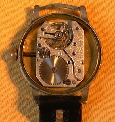

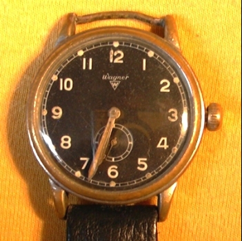

Oliver WulffHello Jim, interestingly enough the company Wagner used just such a movement in a relatively rare 'standard' military wristwatch. These are relatively sought after in their own right. (see pictures) now to turn a Glashuette Urofa movement =Tutima into a Lange watch is a bit far fetched I recon some poor sod will pay USD 1000+ for an incomplete Wagner with a replacement dial.
May 10, 2005, 14:54
Oliver Wulffhere is a picture of the urofa movement in the wagner case. on the wempe watch the hands are wrong (in my opinion) as well as the crown and possibly the movement. it has certainly not much to do with the wempe/thommen watches but maybe someone who knows movements better can comment here.
