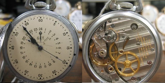

David AbbeAnd Then there was the Longines A9 nav watch which ceased production in 1939! It is a Hacking, Sweep Second 24 Hour Dial "GCT" wind indicator, size 21 Chronograph sold to the US Army Air Corps. Pictured 1938 vintage s/n 5939452 that I adjust every month whether it needs it or not! sigh . .

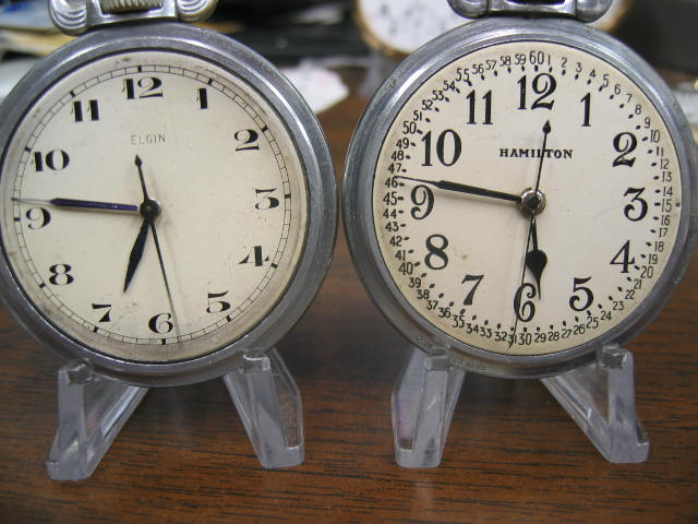

David AbbeNoew here's another "rub" a 12 Hr Hamilton 4992 B and a 1941 Elgin both sweepers and both 12 Hour.
July 01, 2008, 21:56
David AbbeWe are all aware that some Hamilton 4992B's got into civvies with a 12 hour dial, but I have no explanation for a 12 hr sweep Sec Elgin that is engraved "US ARMY AC" on the movement and has a 1941 s/n
Except the sweep sec cock looks like it was made with \a file and a hacksaw, so Elgin must have been in a real hurry to get some of these delivered in early 1942.
