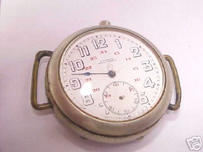

Hi everyone, I'm new here, but frequent many other watch forums. I was wondering where to best find information on this watch. (and possible source for parts) It is missing crown and stem, crown should be onion style crown I believe. Movement looks very similar to an H. Moser I've seen. I have no info on this Ulysse Nardin, and would like to learn more about it.
Thanks!

HiTim,
Ulysse Nardin is a well known and highly regarded brand. They made military issue pocket watches and chronomiters, however, unless there are some military markings on it, I would assume your watch was a commercial private purchase item.
A crown can be found, but the missing stem may have to be made, for I know of no sources for this part.

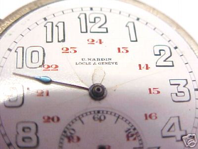

Given the type of numbers on the dial, the hands should be of the pierced skeleton type made to hold radium.

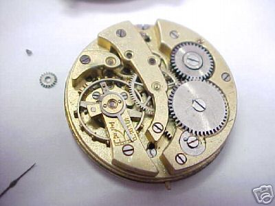

I forgot to add pic of movement. Any additional info is appreciated.
Tim

A crown and correct hands for your watch would most likely have to come from a scrap watch. It's unlikely that new old stock parts can be found. Watchmakers often accumulate boxes of parts watches and if you are lucky the parts you need can be scavenged in the shop. If you are not so lucky, then post a picture in the "wanted" section or look for an appropriate scrap watch on eBay. The watchmaker making the stem will want to have the replacement crown prior to cutting the threads.

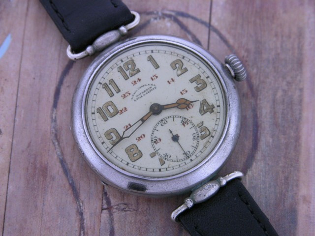

As Greg mentioned it is not a military watch but if you fix it up it should be a nice example of a Ulysse Nardin wrist watch. Here is a link to a thread that has a photo of a nice WW I military Ulysse Nardin trench watch WW I military trench watches I am not sure whether your watch originally came with hands that were like the ones you see on this military watch since it has radium paint on the numbers and in the skeleton hands to enable a soldier to read it at night without turning on a light or striking a match. As for the crown I would think it likely that it could be similar or the same given the comparable vintages. I'm sure if you watch Ebay for a few months you might see a few Nardin's that are similar to yours and you can see what kinds of hands yours should have. Also, since it is a Swiss watch, if you are not successful in locating the correct parts in the U.S. you might have more luck asking watchmakers in Europe as to whether they might have the correct parts you will need.

Is the movement marked anywhere? I don't see anything in the photo. Also, I don't see a marking as to its jeweling - how many does it have? I'm absolutely not an expert in Nardin watches so I am of no help in this regard, but if it is not marked it would be good to assure yourself that the movement is a Nardin and original to the dial rather than a replacement.

I notice on mine that it would have originally had swivel lugs, as I can see the holes filled for these, and that the wired lugs are an old modification having been done. Mine would have looked exactly as the Signal Corps version, minus the fact that mine has blued steel hour/minute hands and lack of Signal Corps on the dial.
The movement is only marked with 299619 under dial, and what appears to be a single number "1" on the back side of movement. Case inside back is marked with "BBR" where the R appears backwards, and also marked with 139049 on both outer case back and inner case back (or dust cover).
I still can't figure out what calibre this is. I will try to get picture of dial side of movement tonight for keyless works. I need to figure things out, as the watch arrived in pieces and when I put it together, I realized that the intermediate wheel and winding pinion are missing. (on top of not having stem and crown) Ugh.

It's driving me crazy. :-)
If I can figure out calibre, I might be able to track down some parts.
Any ideas? TIA

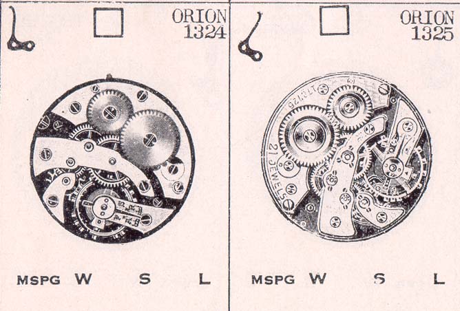

Mystery movement solved. Someone was able to determin what it is. 13 ligne Orion (one on left of image). Now I may be able to find parts a little easier.
Tim

In addition to the differences you mention, yours does not have radium numbers. As such it seems unlikely that it would have originally have had radium filled skeleton hands. The blued spade hour hand still on it may very well be the original one as Nardin used spade hands on many of their watches of that era. Before you invest in finding and buying radium filled skeleton hands you may want to do a little further digging for more information on your watch. Here is an auction (disclaimer: it is not mine and I have nother to do with it) for another non-military 24 hour dial Nardin watch of about that vintage - maybe a couple of years newer but likely pretty close: http://cgi.ebay.com/ULTRA-RARE-ULYSSE-NARDIN-CHRONOMETE...QQrdZ1QQcmdZViewItem

Given that the numbers on the dial are of the outline form, and not solid black, the dial was made for the numbers to be painted in with radium. That's why the outlines of the numbers are printed on the dial instead of solid black numbers, such as the watch on eBay has. It's always possible that the manufacturer used regular spade hands with this dial, mix and match, but radium was in demand at that time and the watch does have a radium type dial.

Thanks guys. Clearly possible that my watch is not military. As for radium on dial, I do not know the history on the watch to determin if maybe someone had removed left over radium from the dial itself. It could have had it before. I've seen these same hands on other enamel dial watches with similar cases etc..
I'm glad I've found some more info about it, the hard part now is getting the few parts I need to complete it. Smile
