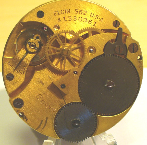

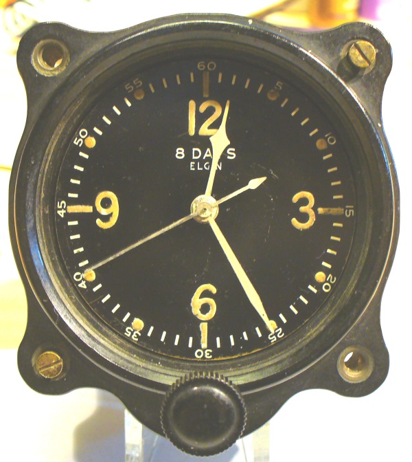

Can you ID this unit? it is a working watch or is it a clock?
It's an 8 day unit as marked. It runs but has a loose cannon pinion.

You have an aircraft cockpit clock of about 1942 production. Most likely made for military use in that year. There may be a data plate or an ink stamp on the back or sides of the case to indicate who used it.
It looks like a nice example with a good dial and hands.

This 562 movement Elgin with the center wind/set knob was used in both aircraft and armored vehicles such as tanks. To tell what you have you will need to show us the markings on the data plate on the back of the case.
With the damage you mention you would not likely get full value in a sale as a buyer would need to factor that into their bid, and it may cost more to repair than it is worth unless a person can repair their own timepieces. A professional watchmaker would charge far more than it is worth to repair it. These generally sell in the $40 to $80 range on Ebay depending on their condition and there are always a number for sale there since they are fairly common.

Jim, It's on the bench now and the cannon pinion is fixed although it was the barrel (Tube) on the second hand that allowed it to fall from 10 to 30 after the hour. It seems to be a strong runner so I will find a nitch to put it in.
Thanks for all your input.

Is there a dataplate on the back, or perhaps even ink stamped markings? If so they could be helpful in determining if this one was meant to be used on an aircraft or an armored vehicle like a tank.
August 30, 2013, 12:29
Patrick Wallin
The only marking on the case, sides or back is a 119 engraved into the case. There are no other marks or inkings.
August 30, 2013, 21:28
Jim Hester
Thanks. Perhaps someone removed it along the way in its life. As such there is no way to tell which use it was put to.
