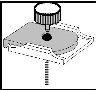

I have the 1940 Longines Weems pictured . When I acquired it the 4:00 locking crown was missing as so many are . The hole was plugged with brass pin stock polished flush with the stainless steel case.  Today I finally got around to pushing this brass out ,chasing the threads clean and making new parts based on fuzzy old photos and some guess work .
The main flaw in my first prototype is that the jaw of the L shaped "locking washer" wants to turn out of alignment when locking down against the rim, an annoyance that I am sure was addressed in the original design but how ?

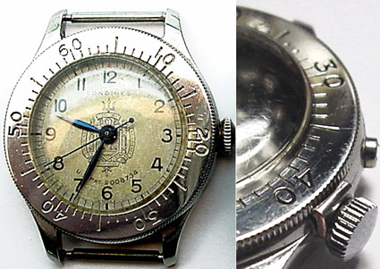

The split photo to the right of the main one is of the newly made lock held on for now an incorrect crown. Does anyone have good photos or a detailed description of the original locking washer on the 4:00 crown version Weems ?. The 2:00 crown version Weems came later,was cased in a keystone case and looks like it had a slightly differentlock but even this might give a clue.

Anthony CrisciThank You Greg, I will check them out. The Emblem is that of the U.S. Naval Academy at Annapolis where Lt. Cmdr Weems taught his Weems Navigation system. I see these dials only on the 4:00 crown models but never on the 2:00 so I am wondering
if the 2:00 crown Weems might have been made after the war. The Patent number is below this shield.
 Yes ,it has two teeth but that does not stop it from wanting to turn. There is a Weems up now that has a few very good shots of the Crown lock . A square lock washer is sitting in a little U channel to keep it from twisting. All very self explanatory and an easy enough project but the washer looks too big and the rear section of the channel looks roughly finished so I am not sure if this is the original lock or a reproduction modeled on the original ,maybe by memory . It also looks seated in a channel cut in the side of the case ,I have no such channel or signs that there ever was one.

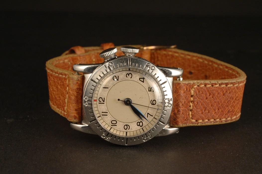

I had always been of the opinion that the "2:00" version, aka "little Weems" were actually earlier than the larger "4:00" version. I had understood that the Weems had already been declared obsolete prior to the war, and was being phased out of military inventories, explaining the rarity of the Ordinance Dept. marked models.
     This one came to me with a letter of provenance from the original owner that put it's date of purchase at 1940. The 6.1 million range serial number also indicates 1940 production. I've seen RAF stamped "big Weems" with dates as late as 1943 (which of course means nothing about actual production dates).
Here is the back side as well...
     The watch was sold to me as being all original, and there was no indication that either crown, or the locking clamp had ever been replaced.
One more view...
     This one is on it's way to a collector in Japan, but I'm sure I could get more detailed pictures for you if needed.
Cary

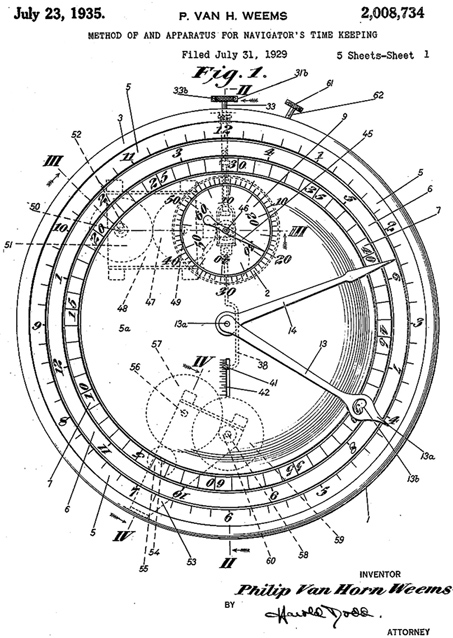

Anthony CrisciIn case anyone was curious here is the first page of the Weems U.S. Patent #2,008,734 listed on the dial.

    And finally, the patent drawing is for an earlier and more complicated version of the second setting watch, involving a smaller integral dial that was inset into the main dial, and turned with the crown (a setting button allowed the crown to turn the inset dial) to align the seconds with the hand. The turning bezel was a simpler approach to the same thing. I've seen one pocket watch with the inner dial feature.

That patent by the way is the patent number that are on ALL Weems dials that have a number, not just mine.  The why it is there has to do more with marketing then truth I think. I believe the only item on this watch that is really covered by the Patent listed is the idea of locking the bezel to the time,nothing more.  Even the rotating bezel idea was invented before the Weems.
All Weems watches civilian or otherwise will have either the this Weems Patent number or the name Weems or both.  If missing then it is not the original dial.  That much at least most everyone agrees with.    And a Weems dials on a non Weems style bezeled case is just a mismatch,not a Weems watch.

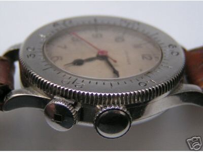

Aldo FeruglioAnthony, i remember a detail that someone told me time ago, regarding the bezel locking crown.
The screwed part ends, where is fitted to the crown, with a square shape.
It has not the threaded tube inside like common crowns.
Here is a pict. showing the crown.
About the back, unfortunately i have no pictures but i think it have to be marked by Longines.

Anthony CrisciThank You Yes I saw that feature early on from the photo I found below. A normal screw on crown might come unscrewed from the post so its only logical to do that. I thought it looked like they took a stock watch stem and used it upside down so I made a rough one like that to see how it worked and it did fine.
