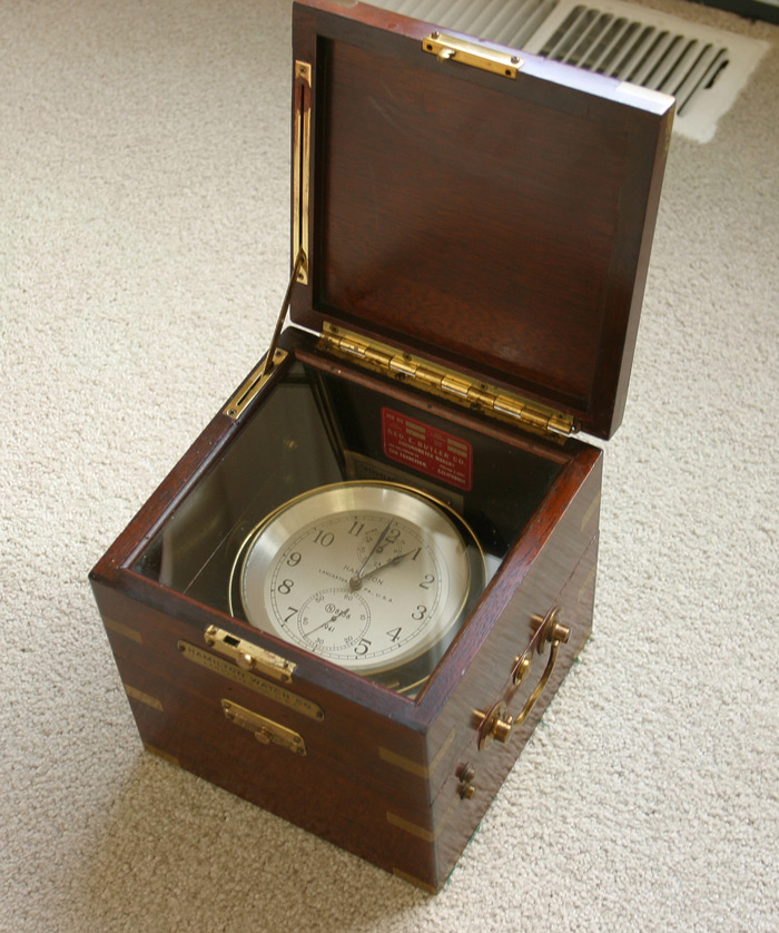

Mark de RegtThanks for the help. I contacted Chris, who doesn't work on clocks as big as this one, but who advised that I should leave well enough alone, and not service it until it's running less well.
I understand it's technically a watch, although it's a big one. The box is 7.5" on a side:

Tom BrownHi
It is a model 21 14 jewel fusee movement correct? I have always wanted one of those.
March 05, 2009, 14:37
Mark de RegtThat's it exactly.
It's quite petite, compared to my clocks, and very attractive. Its ticking is very distinctive.
It seems that they're not getting any cheaper, and more and more they're ending up in eastern Europe and the far east.
I decided that when I found what looked to be a good one, from a source who understood how to ship these sensitive clocks, I'd buy one.

Jerry KingMark, my suggestion is, and that is all it is, would be; Since you have timed the clock somewhat to within 2-3 seconds per day accuracy then you have a good barameter to go by....
If you run the clock daily then monitor it periodically and if the time accuracy starts deviating from the norm by percentage points or seconds, then it's time to have a master clock maker take a look at it....
I agree with Jim in that if it has been five years since the clock has been serviced then I would error on the side of safety and have it serviced. Then you would at least have a definite reference point from which to proceed with.... I have no idea how much this timepiece set you back but I'm sure that it was substantial and with that in mind you do need to protect your investment....I would think, anyway....
It is a beautiful timepiece and I really appreciate your showing it here to us....
