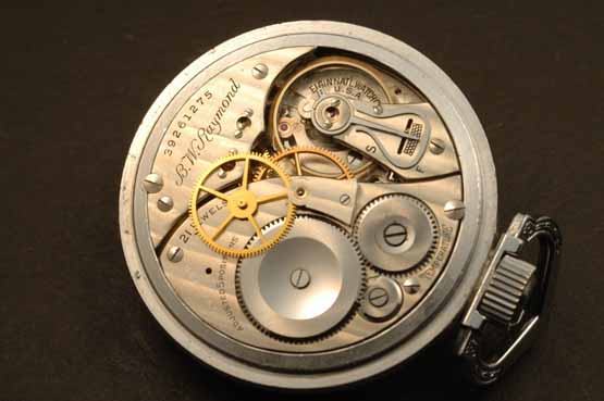

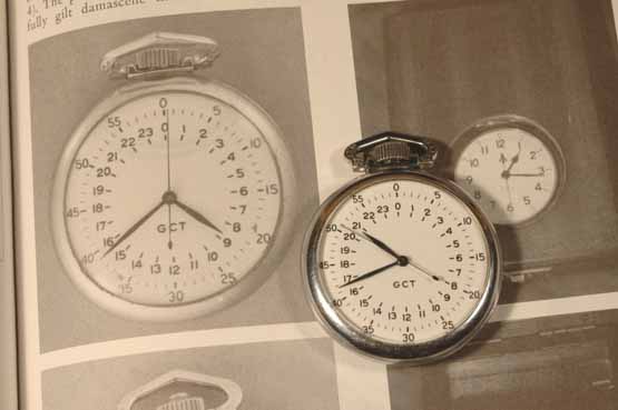

This watch is the 4992B type with a white 24 hour GCT dial & sweep second hand. The case has all the Elgin Military markings.
My question is; It has black hour and minute hands but a white sweep second hand. Is this correct?

The hand should be blue steel and the case nickel. Some of these earlier white dial CGT also have U.S Army A.C marking on the movement.

I have a BWR with a white GCT dial, and the hands on mine are black.

This is a 581 also. I guess I'll just leave the white sweep second hand on it. It's a nice carry watch that I don't have to lever set.

October 06, 2007, 09:52
Jim Hester
