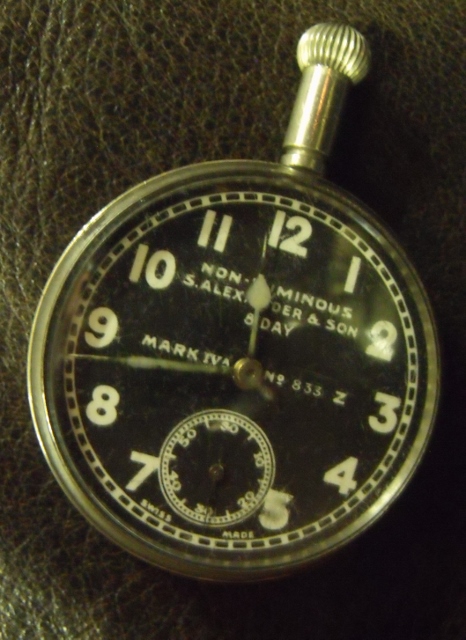

John WillisI know this is a pretty old thread but i would like to share a recent Mark IVa that I acquired.This watch came from an estate in eastern Ontario., Canada. I know no other history as yet. When acquired it was missing crown and stem and non running. It had obviously been sitting for many years and was pretty badly frozen but no obvious H2O damage. After some time I was able to disassemble the watch to find a broken pivot on the escape wheel and a badly damaged clutch wheel (someone trying to turn hands when frozen). After cleaning and replacing the broken parts it is once again working well. I think the crystal to be original so have left in in, scratches and all. I will include a few picturs which will save me making this narrative any longer.
QUESTION I HAVE.
A)Is the Black second hand correct and if so why was it used?
B) Sth..is the theory re. the Southern RR marking them still valid or is there new information on this?
C)This watch has non-lume dial but hands have lume applied to them. Probably others like this but does it have any significance?
May 20, 2019, 20:50

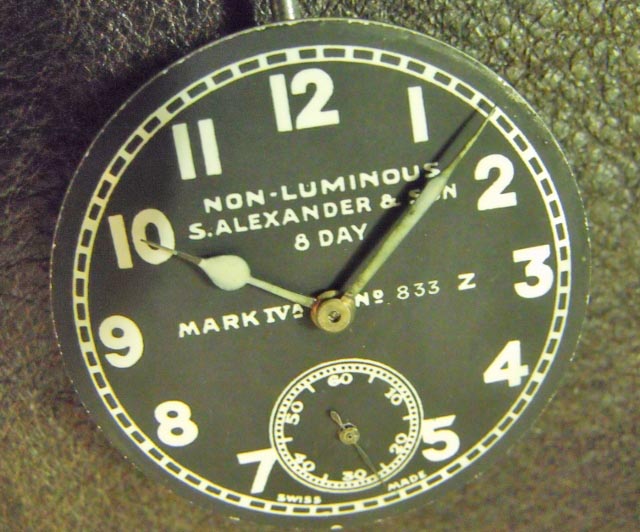

John WillisDial says: Non-Luminous
S. Alexander & Son
8 Day
Mark IVA No.833 Z
The dial is non lume but hands have lume applied to them.
Pendant is not drilled for a bow.

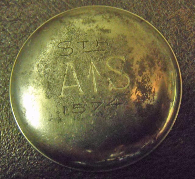

Back has stamped A^S (letters are 3/8' high). as well as Sth and the no. 1574 stamped with the same stanp that appears to have a serrated edge. The S is made by using a "c" stamp and turning the lower part backwards. I think not unique.
Movement is OCTAVIA 8day, serial No. 69629
Any help or comments are welcome. Many thanks to Jim, Greg and the many other who have contributed to this over the years. The result of your hard work is amazing. Thank you all, John

John Willispic of back

Jim HesterThere is still much to be learned from these so my answers should be taken with a grain of salt, but I will respond with what I believe based on looking at a great many of these over the years.
(A)Is the Black second hand correct and if so why was it used? The second hand should be painted white. A black painted second hand against a black dial makes it almost useless, especially for a pilot who is trying to fly his machine while it is vibrating substantially from its relatively crude engine.
B) Sth..is the theory re. the Southern RR marking them still valid or is there new information on this? I have not been able to absolutely confirm or debunk this theory. These watches were well made and during the war and after the war more than a few received supplementary markings - either military markings such as timepieces that were sent to the armies of British commonwealth countries or ones that were sold off to the public as surplus where their owners applied their own markings sometimes. Being re-purposed by the Southern RR is a plausible story for Sth marked watches. The number 1574 that is engraved on the back of your watch is not a military serial number, that number is on the front. This 1574 is a number that whomever marked the Sth marking added.
C)This watch has non-lume dial but hands have lume applied to them. Probably others like this but does it have any significance? The correct hands should be painted with white paint, not lume. Someone at sometime decided to make this particular watch readable in the dark and painted lume on the hands. It could have been anyone at any time and it is not "correct" for this watch. If you go through this thread you will be able to see what the hands of a Non-Luminous dial are supposed to look like.
