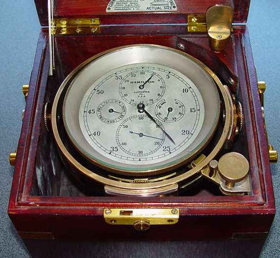

Hi.

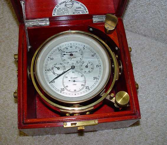

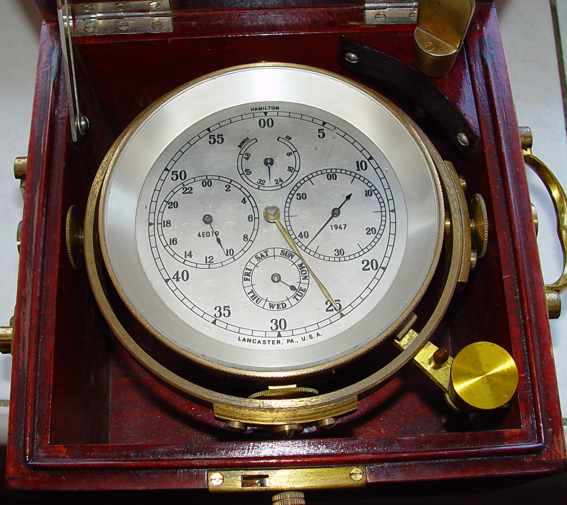

I own Hamilton Chronometer 4807 with the same layout as 5060, 1903,1209.
Ever since buying it on Ebay, I have scanned the internet for these. A couple of weeks ago 4E019 was lsted for sale on Ebay. I didn't bookmark it. and couple of days later I could not find the listing. My continued search on the internet Paid off! After talking my C.F.O.(wife)into it. I made the purchase. Now of course 4E019 is the correct s/n and this one has the same layout as in Whitney's book. At some point I hope to have a Qualified individual to pull the dials on both 4807 and 4E019 and see if 4807 looks like orginal type work, and document this either way, with Photo's. 4E019's box doesn't look quite like standard Hamilton issue, but I think it is important to remember these chronometers spent about 60 years in the Soviet block and cleaning and adjustments or repairs would be made at thier chronometer factory. I noticed 4E019's minute hand is gold tone like a soviet job. Perhaps Hamilton sent the chronometers only in tubs. We see these come up on the market frequently. Has anyone seen one of these before? The seller said it came out of an observatory in Irkutsk.
4E019

More PICTURES
4807

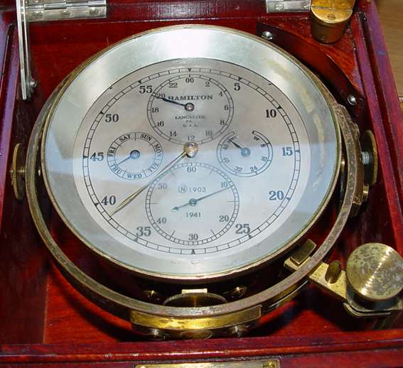

More pics
1903

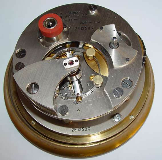

No numbers on dial and no damascening on plates.
Dentaltime
April 17, 2008, 22:50
Kenneth R. Brown, D.D.S.
MVT 12509 dial is one above

Welcome Aboard Kenneth,
You have a some beautiful items, congratulations on acquiring them.
About where the box is original, from what I can see of your three examples each of your boxes sure look to be exactly the same as we find on known to be original Model 21 Chronometers. As an example, I have only one but mine is numbered (N) 152 and that number in addition to being on the dial and movement is on plates attached to both the inner and outer boxes.
If that additional number plate is on any of yours it might help in the authentication.
April 17, 2008, 22:59
I own only 4807 and have purchased 4E019 (haven't got it my hands yet) the others are that have come up on sale. I know 4807 doesn't have the # on the box. I am pretty sure the others with the hour orbit at 12 position don't either, not sure about 4E019.

Some guy's have all the Luck! (Bad) Another collector informs me that 4E019 is a FAKE. Well, at least they did a convincing job on this one. Reported the collector has seen the works under the dial, and it is not Hamilton Stuff. I am working on getting my $ back. Perhaps someone will be helped by this. Ken
