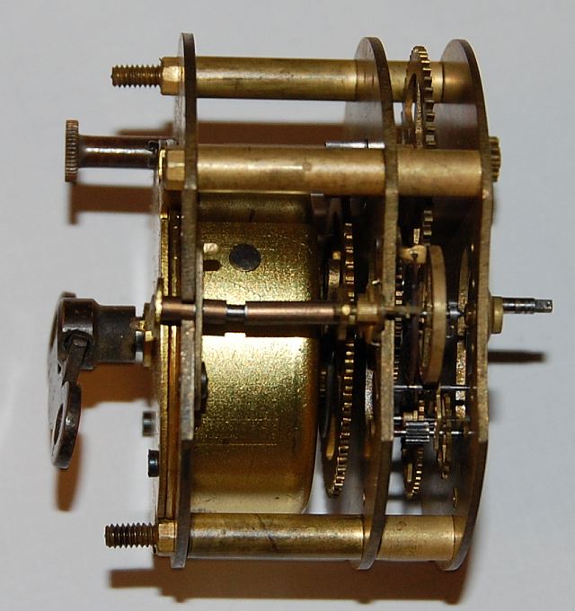

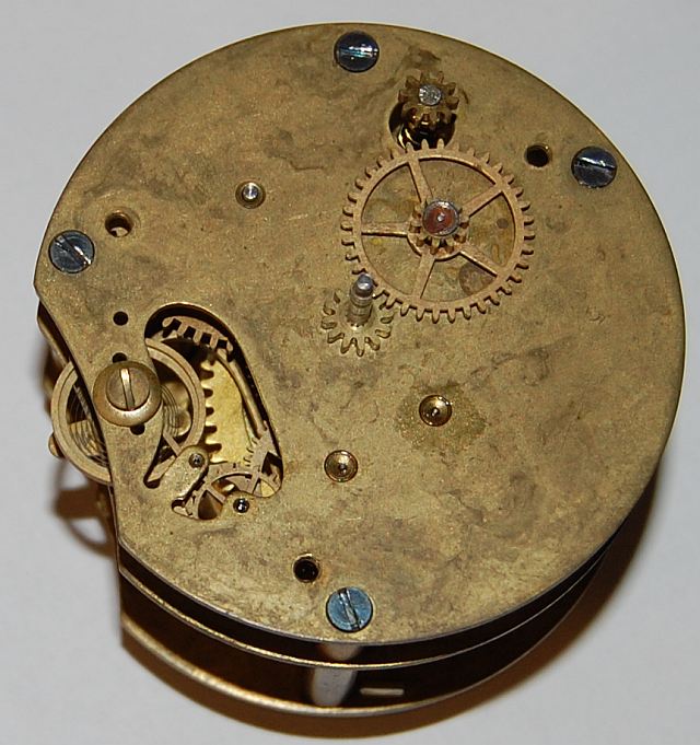

Picked this up yesterday at a yard sale. I've got it running now with a little lubrication to the pivots. But, I'd like to take it apart and clean it. I don't know how to let down the spring, but since it's running I think I'll just let it run down on it's own.
Any experts out there who can tell me how to proceed? I think all it really needs is cleaning and proper lubrication. But then again, I have no idea how accurate it may be.
I've never seen one before and have never disassembled one.

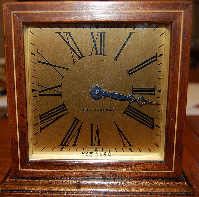

Dial side view:
Dave Turner

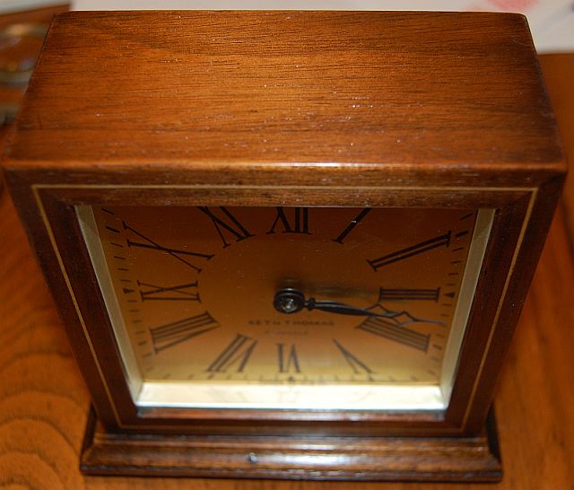

Crusty old case - needs refinishing.
Dave Turner

I'd like to know how to let down those big mains, too. I've get several Seth mantle clocks that have been given to me, and the mainspring are exposed with no cage or barrel to contain them.

As for disassembly of this movement, is there a proper order to it? Maybe I should ask, what is the proper order?

The movement is an inexpensive one and actually these can present more difficulty than a higher grade movement. The biggest problem is to not ruin the delicate hairspring. You need to remove the pin holding the hairspring end so the balance assembly will be able to be removed. The balance staff rotates in a cone shaped device which is robust and adjustable for end shake, but which also has relatively high friction. If you have a digital camera, take pictures as you start taking the movement apart so you will have a reference for reassembly. I can't give you a step by step for dis-assembly, but it should be fairly straightforward since this is a simple time only movement. Once apart carefully examine the pivots and pivot holes for wear. The holes tend to wear in an oval shape. The best way to repair worn holes in plates is to re-bush the plate sizing the bushing to a properly cleaned and polished pivot.

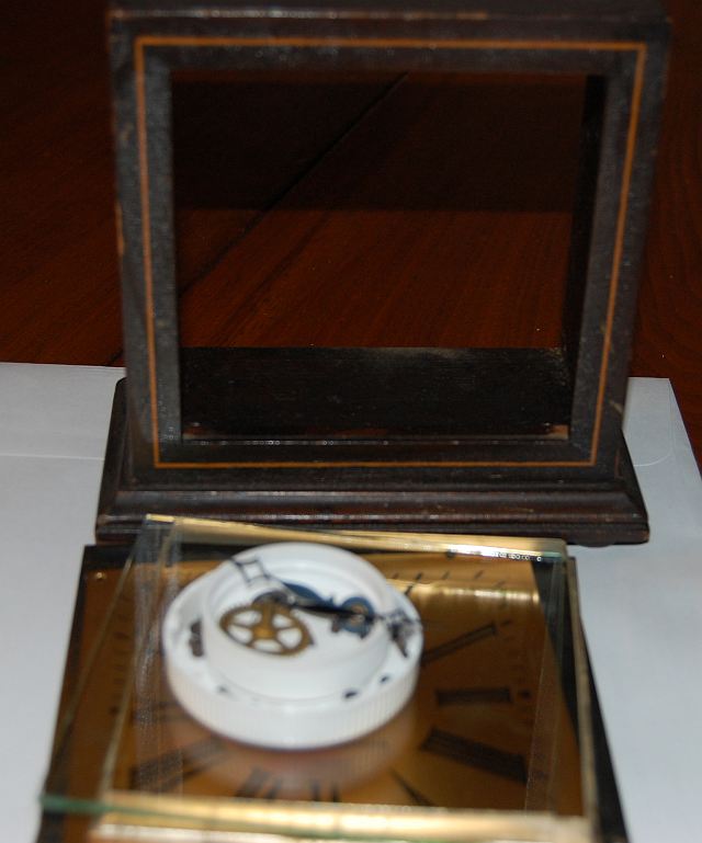

Seth Update:
Refinished the case and put her back together.

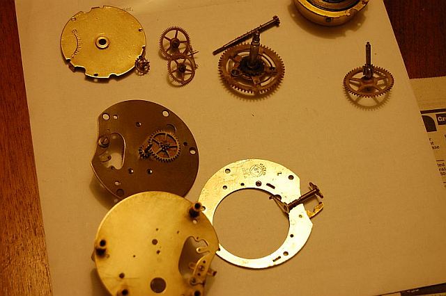

So, I'm going to start over. Not sure exactly what I did before but I'm going to complete dis-assemble the balance wheel and clean the mainspring.
I imagine that's where the trouble is.
