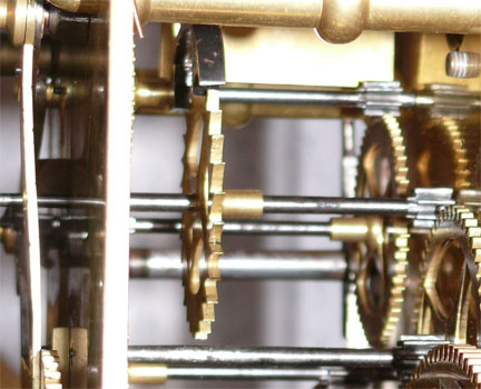

December 20, 2006, 18:14
Norman BlissThanks John & Tom. I returned to the shop today and took pictures of the clock. Turns out to be just a plain old recoil escapement after all; the seller noted my comments the other day, and leveled the clock better, and now it recoils on both beats. As you can see from the picture, the teeth point away from the direction of rotation, like any recoil.
