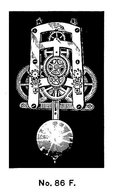

This information is from the SETH THOMAS clock and movements book by Tran Duy Ly. The movement looks to be a # 86 and the clock is called "WORLD"
As to how to do it a better way, is a good question. What ever works I think.!! I'll see if I can get a couple pictures on here of the movement and description.
Bill Carlson
September 29, 2009, 15:27
Bill Carlson
2 the movement with a short drop..
