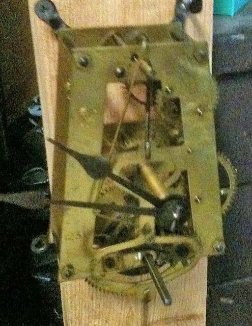

Id there a good site or posting how to Id Seth thomas movement. If not could we start one here. As I am starting to look at clock in a different light. This came out of a school house style case.

Richard HamiltonI would like to know more about this Seth Thomas if any one can help? I am pretty sure it is one of the big old regulators but I don't know for sure!
November 16, 2011, 02:29
Tom BruntonThe only thing I know about that beauty is that I know I wish it was mine
November 16, 2011, 09:11
Eugene BuffardRichard show a photo of the escapement area of the gears. So someone might give you more info. The only thing I know is if it has a second hand it is a good one. Yours has a second hand at the center. Which would have to be newer. is it a second hand. And then Lindel has his model 2 with out a second hand. With out a second hand it is hard to get it dialed in to 10 seconds a week.
November 16, 2011, 10:07
Michael RiskaRichard, I don't have a picture but it looks like it might be a 67 (A?B?) Either are 8day, weight driven, sweep second hand, keystone plate, 42 1/4 in pendulum. Length 7 11/16, width 7 5/16, depth 5 5/16 From a no.16 or 19 regulator. Someone else may know better! Mike
November 16, 2011, 10:09
Michael RiskaSorry, It should have a deadbeat escapement and is from the 1907 catolog

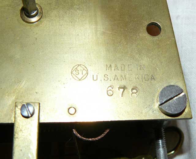

Richard HamiltonWow! A lot of helpful info, here is a pic of the numbers on it,

Eugene BuffardI.m no expert but it sure looks like dead beat escapement. They where sure housed in a beautiful case both the #16 and #19. I would be proud to find a case and get this back together if I where you.
