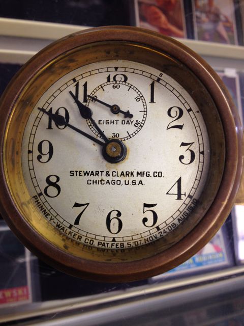

This is a clock that a local shop called me up to take a look at. It appears to be made for a ship. The case is made of brass. with this very heavy mounting ring. It has no way of winding it. You can unscrew the front bezel. But does not have a way to wind it from there either. It must be a automatic movement of some sorts.

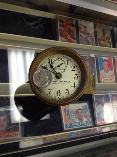

Here is the 2nd photo

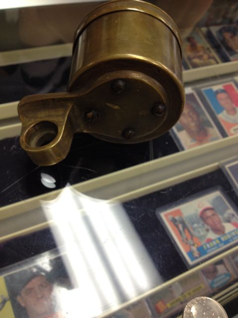

3rd

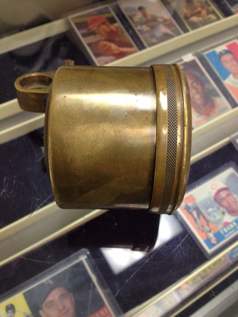

4th

Here is a link to a completed EBay auction for a similar clock. It is a car clock and is called a "rim wind" so I guess it is wound by the knurled ring next to the bezel. I found another auction which said the clock is wound by turning the ring in one direction and the time is set by turning it in the other direction.

General Motors in the 40's and 50's had similar models which were actually mounted in the steering wheel attached to the wheel spokes. Later 50's models, such as the Oldsmobile Rocket 88 had "self winding" ones with a cut out window which allowed you to see the swinging weight move back and forth which actually "wound" the clock as you drove. There were quite a few in the "junkyards" of the 60's. Wish I had taken the time to get a classy steering wheel with one of them. Be great to have today!

Are you certain that this is not a rim wind clock? Phinney-Walker made a number of different rim wind movements. Can you turn the rim both ways?
September 20, 2014, 19:46
Eugene Buffard
Yes if you turn it counterclockwise it comes off the case. Then you can turn it clockwise to screw it back on.

It's an "eight day" movement which means it is manual wind. Perhaps it's wound all the way up ? When you say it comes off the case when it is screwed counterclockwise, is the "knurled" part made into the bezel as in one piece and does it come off as one piece with that bezel ??
Interesting small clock.....The brass case is typical of a water vessel clock that may have been set in a small boat steering wheel. It looks military style....

The bezel holds the glass ONLY!
It does not. Wind the movement.
