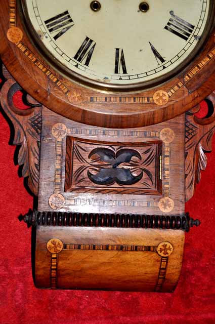

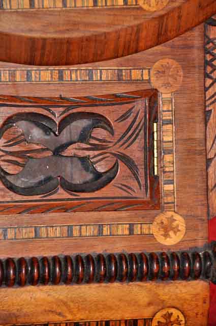

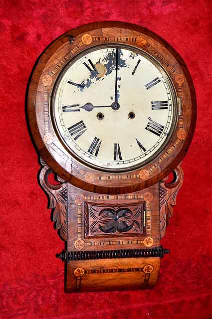

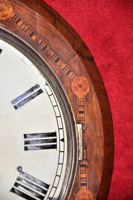

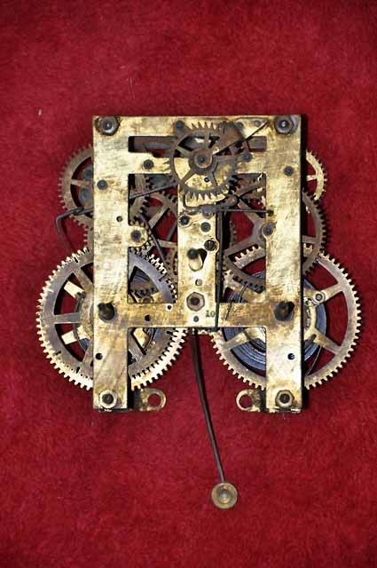

Hi all, I recently acquired this clock that I believe to be by the Anglo American Clock Co. Can anyone tell me anything about this company and approximatly when this kind of clock was produced?
I think the movement is a New Haven and I haven't found time to redo it yet. It's only this clean because I doused it with Brake Cleaner to get the majority of the gunk off. Any best way to remove the GOLD PAINT from the plates? Mike

Buster BeckWell I can't help you on the movement stripping Michael, but I will say this
That's as pretty a inlaid/veneered/carved case as I have seen anywhere without being on the side of gaudy
I would hope there may be a porcelain dial upgrade and a beveled glass door to make this one dynamite wall clock

Michael RiskaThanks, Buster for the kind words. I plan on a good clean up of the case and Lindell put me on to the Dial House lady for a repaint of the original dial pan. Thanks again Lindell. Mike

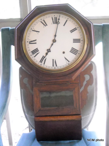

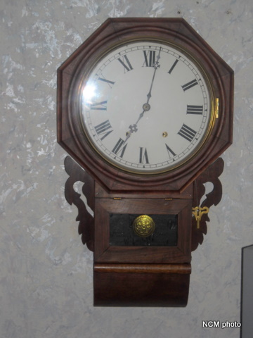

Norman MayberryHi Mike.The Anglo-American clocks had English cases and American movements.They had labels inside that said"Anglo American Clocks for use at Home and Abroad".No movement genuine without manufacturers trademark.Here is one I completely rebuilt.New octagon head,new veneer and repaint on dial.The Dial House does awesome work.Martha has several for me.Picture is not the greatest and not near as nice as yours,but as a woodworker I enjoyed doing the work.

Michael RiskaHi Norman, Thanks for your reply. Your wood working is really nice. I would never be able to redo a case like that. Is there any way you could photograph the label so I might know what they look like? Mike
ps. Your photo confirmed what I had hoped. I had a Japanese clock with this pendulum bob and when I got the A A I thought it might have a Japanese movement in it. Come to find out ,the Japanese clock has an Anglo american bob.

Norman MayberryGood Morning Mike,Give me a day or so and I'll take mine off the wall,disassemble it and take more pictures.Your movement looks American.Look for a trademark on the plates.Mine is a New Haven.Some had E.N Welch movements,some Seth Thomas.I think most American clockmakers sent movements to England to be installed in these clocks.Try soaking your movement in mineral spirits to remove the paint from the plates.I'd do it outside or in a well ventilated area.Good clock cleaning solution should work also.

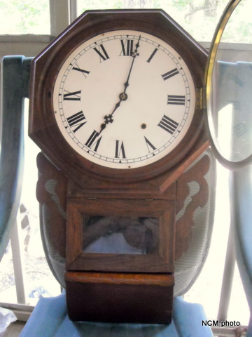

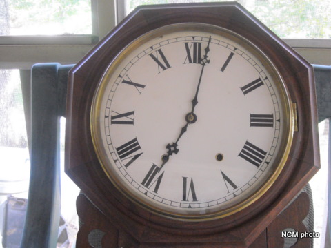

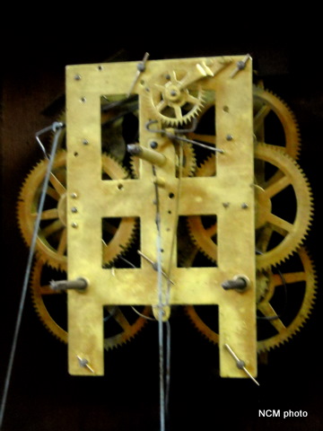

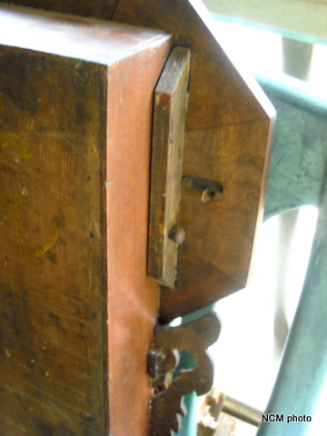

Norman MayberryHi Mike,A few more pictures.taken in a hurry so aren't the best.

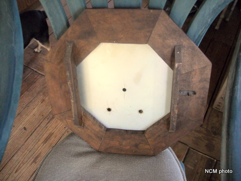

Norman MayberryBACKSIDE OF DIAL.IT'S A REPLACEMENT THAT WAS ALREADY ON THE CLOCK.

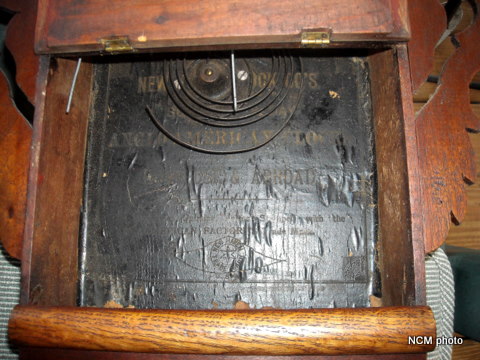

Norman Mayberrythis is the label.Kind of hard to make it out.Very difficult to get a good picture.Not many clocks this old still have a full label.

Michael RiskaThanks for the pictures , Norman. I appreciate the trouble. I'm not sure what my movement is. The only mark on it it the 10 which I assume is the pendulum length.

I have never seen a movement with paint on it, but some have lots of grease, oil and other stuff. Good old home oil jobs!
I just serviced a clock really similar to this one of yours. I never could find a maker of the movement or case. It had great inlays on it just like this. I finally came to the conclusion that it was a Japanese clock. They were really good at copying movements in the late 1800s.
But you really need to disassemble the movement and soak the parts to really clean it up good. A cheap but good solution I have found is Simple Green if your only doing this clock. Then rinse and clean each part and dry them well so there is no rust. A hair dryer works good.
