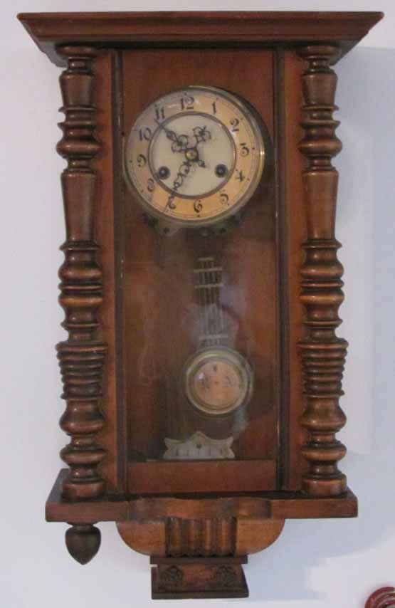

Hi Everybody,
I received an old clock over the holiday and know nothing about it. I am a pocket watch man. Anyway, I am posting several pictures. If anybody can help direct me on how to identify when it was made and the manufacturer and any other info about the timepiece I would appreciate it. It does work and keep time, although it is clearly in need a clean and oil. The bong or chime tries to work, but doesn't make a sound. That is to say there is a winding hole for the chime and there is gear motion at the half-hours but no "bong".
Thanks, John

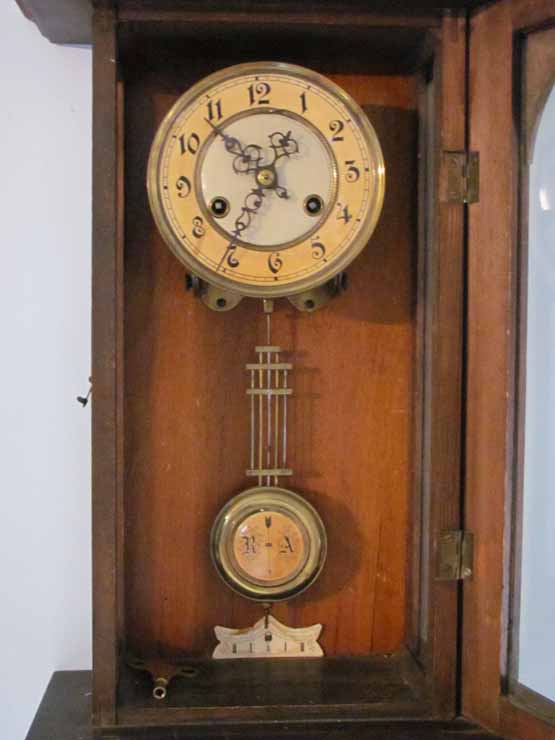

John BealeInside picture of the front...

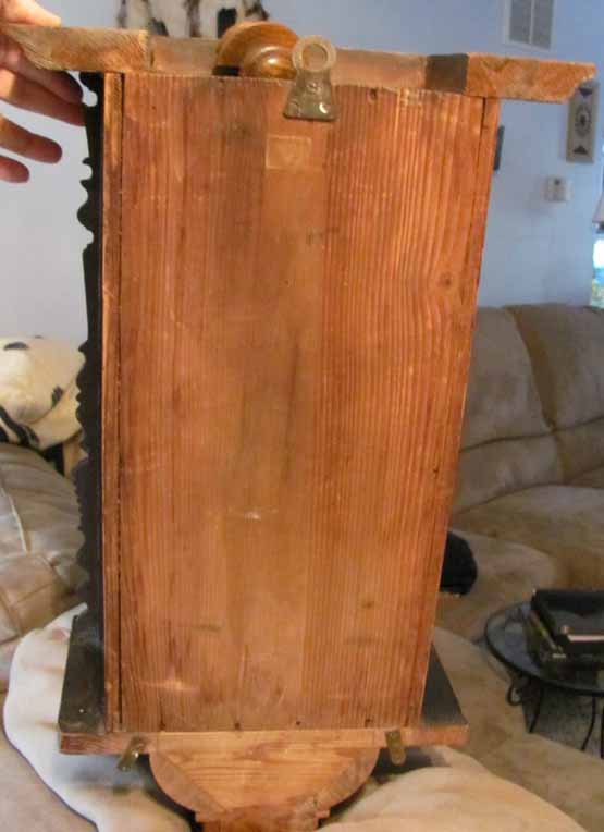

John BealeBack side ...

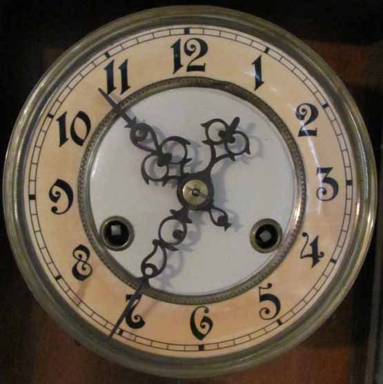

John BealeClose-up of the dial ...

Werner RosierHi John,
your clock is probably a german Junghans spring driven wall "R-A" regulator clock from the beginning of 1900., if the pedulum is still original to the clock.

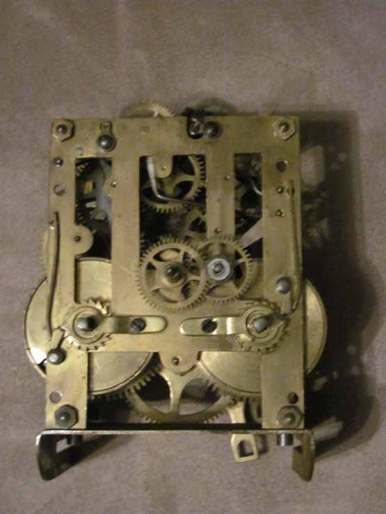

John BealeThanks Tom and Werner. I did get the movement out and inspected it for any markings ... nothing. Not anywhere on the movement or back side of the dial. It does indeed have the look of some of the Junghans clocks in your link Werner. I have seen earlier pictures of this clock and it had a nice wooden carving of a horse on the top in a similar fashion to those at your web site. It has been lost.
Here is a picture of the movment ...

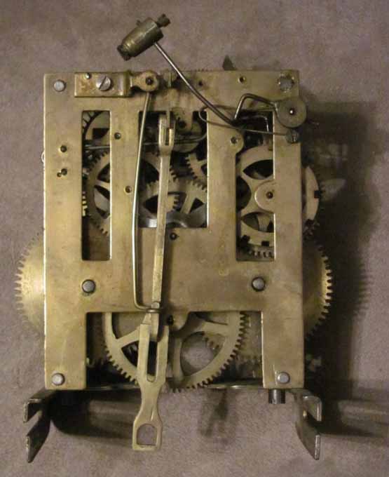

January 09, 2011, 17:18
John BealeThe other side of the movement ...

John BealeCan someone explain what the "R-A" stands for???

Tom Brunton"retard-advance" for the Europeans,or in English,"Slow-Fast" if you turn the adjustment nut on the pendulum in one direction or the other it either slows or speeds up the clock

Bill CarlsonThose click springs are different from any that I have ever seen. That should be a good clue for anyone that has seen them before.
Usually Junghans are marked pretty well. It will be interesting to see if anyone identifies it. Was there a top piece on the case or slot for one? It would maybe be similar to the one on the bottom. You will notice most of the clocks on Werners site have the top piece.
Its a nice clock and the movement looks OK.

John BealeHi Bill. Yes, there was a top piece. However, it has been lost. Probably will never be found. I am told it was a wood engraving of a horse.

Jerry KingJohn, you can adjust the hammer that produces the "Bong" at the 1/2 hour and on the hour by slightly bending the hammer arm down slightly, not much, just slightly until it strikes the music rod at the prescribed timing....

Moses GingerichI bet Werner has some good insight, but I would add that it may even go before 1900. The click springs, and other features point me to the earlier time frame. Don't let anybody talk you into replacing the movement with a new updated one. Cleaning, -perhaps some bushing- and it will be like new again, complete with the designs like the click spring will make it all the more nostalgic and valuable. It is nice! Would be very nice if you could get it id'd closely and have someone copy the horse etc. on top!
