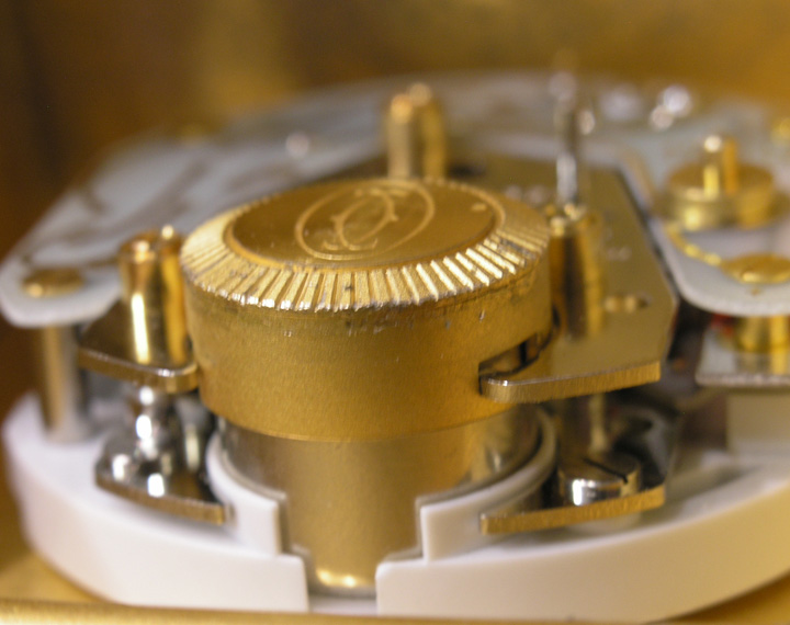

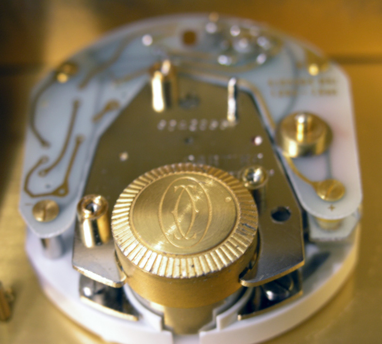

Not seen one like this, so how does one replace the battery in it? The cap with logo does not appear to turn off, pop off and I'm not about to experiment. Anyone had experience with this type?

Side view....

So, upon further examination, the gold cap has to be pressed down with a good deal of force and then turned clock-wise about 20 degrees. Then the entire cap comes off and below sits the battery... an LR50. It's about as tall (or taller) than it is wide!
