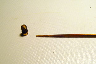

I am restoring an old German mantle clock that has screw in chime rods. It is a Westminster chime and the rod that is broken is the hour chime, not one of the tuned rods. The rod is broken off at the place it joins the screw. Can I have it welded or am I better off just getting a new one? I like to keep every part as original if at all possible.

You could try taking out the screw, putting it in the lathe and drilling down the centre at diameter very slightly less than the rod. If my recollection serves me right the chime rod has a small "neck" in it which is usually where they fracture. Reduce the length of the chime rod by removing the neck and make it a tight fit in the screw hole. Use a clockmakers broach if its a bit tight. Then turn a new "neck" in the rod. Job done! The tone maybe slightly different but this shouldn't be a problem. It takes longer to write about than do.

I had not though of that. Take a look at this and let me know your thoughts. I suppose I could drill it out but would I need to turn down the rod as well? I am not sure enough remains of it unless I really shorten it. That would not be that big of a deal. It would give me practice on the lathe.

I once tried to shorten a three-chime set of rods because it was too long for the case. I carefully marked each rod and cut off the same amount from each. It changed the tone completely. If you're going to drill out the screw you might try swapping ends of the rod and putting the thick end in the screw and turning a neck there; the rod would stay the same length but I'm not sure about any change in tone. You might be lucky enough to find an older set of rods and the cast iron block at a Mart.

Go on have a go - nothing ventured nothing gained. Its on the strike side so a change in tone won't make much difference. Seeing what you have I would just turn the end of the tapered end of the rod parallel for a short distance and the drill a hole in the screw so that its a tight fit. If necessary try a smear of loctite.

Hello Richard ,im going to tell you my experience with rods ,im use to made a hole little less than the rod diameter on the brass screw notch and with a punch i take of the broken part ,then with a piece about 1 inch larger in length piece of steel or brass depending the original mterial ,file the new rod end little bit tapered ,after that hold the rod in the vice (soft jaws) and hit on the original screw checj it if it is gently tight ,
ones you finish it ,hold the rod in the lathe chuck ,leaving place between the brass screw and the chuck jaws, make it run and with a fine file start filing near to the screw making this part of the taper thinner than the one near the chuck ,ones the thinner part is about 2 mm stop ,now check the lentgh with the original one and cut it to the same size at the free end of the rod ,now the work is done listen to the tunning and relax!!! ,hope it helps Andrés
