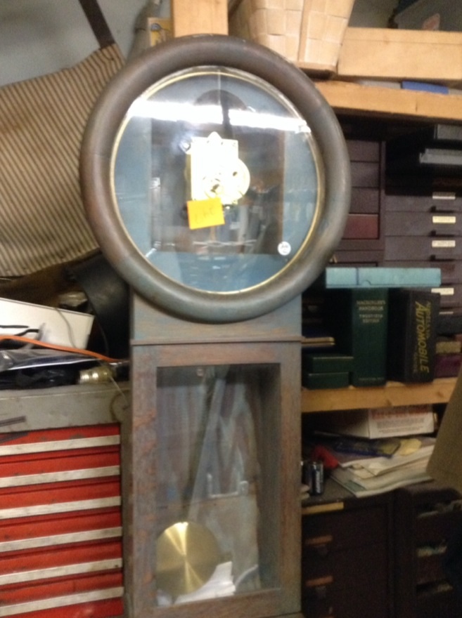

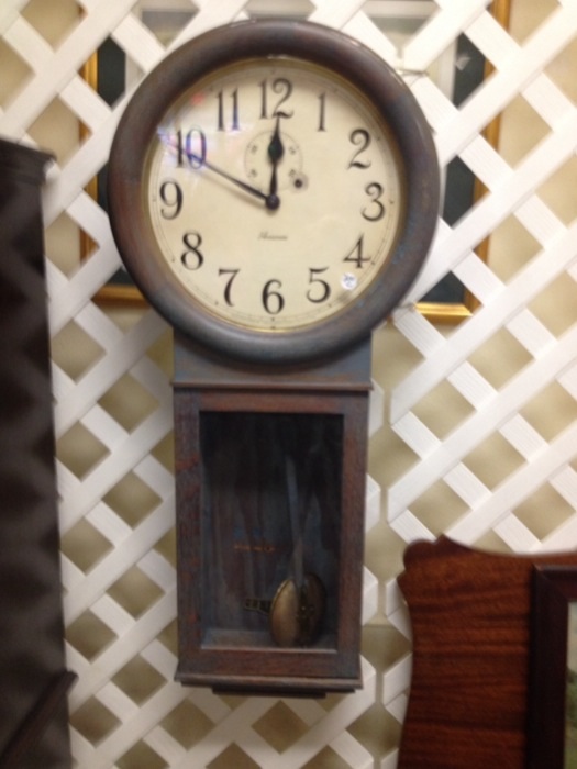

I just bought this Ansonia regulator that is weight driven and has a second hand. I need to know what size weight will I need to buy. Plus the name of the broken / missing part that goes on the top of the pendant stick.
Any other info would be helpful. Thank you ahead of time. And please correct me if I'm Calling some of the parts by there incorrect names.
I'm a watch guy that is starting to look at clocks.

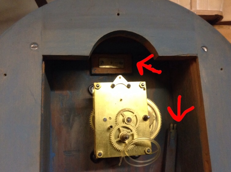

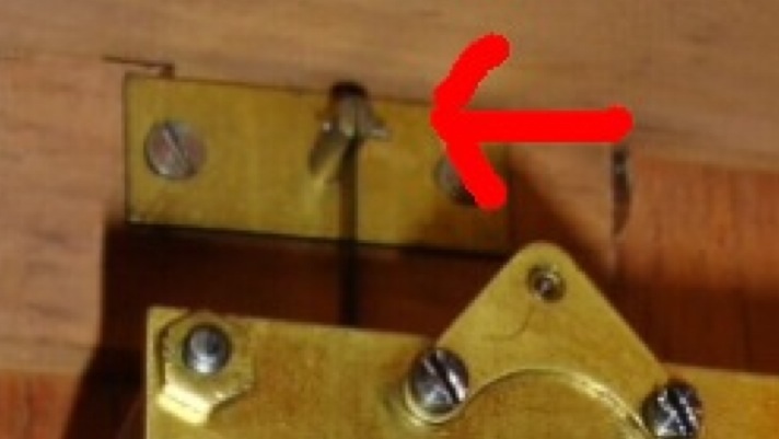

Here is the photo of the area that has the missing / broken piece that should hold the pendulum stick up.

Thank you Dave. Yes I can make this part. I have some round brass stock and I believe I have a thin suspension spring. I might have to take the dial off my seth to see how the pendulum stick is attached to the thin spring.

Are you talking about the post with the slot or the pin that goes through it?
Also, Timesavers might just have the spring and a pin.
Seth #2 parts might be considered too, as they are more plentiful. Might be able to adapt.

The post with the slot. Is what I am going to need to make. Ok I took a piece of round brass and turned it down to fit the flat piece of brass that was still attached to the clock. Cut a slot. Then found some broken suspension springs and fab ed a new one. The pendulum rod is now hanging and swinging.
Now I need to buy a cable and borrow the weight of the Seth #2 to see if it will run.

Here is the brass post before the slot cut in it.

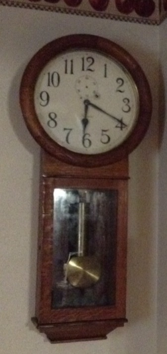

September 16, 2014, 19:18
Eugene Buffard
It does have a maintain power like my Seth #2.
All the blue paint off the case. Hanging on the wall and keeping time.

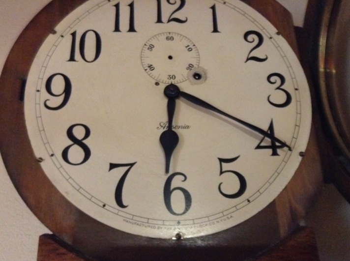

Eugene Buffard
Here is the dial.

I'm still waiting for a second hand from timesavers.
I guess you noticed the damage around the winding arbor.

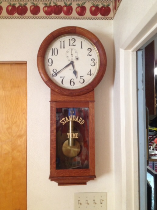

Eugene Buffard
Here is the finish clock. Second hand. Gold transfer and all.
