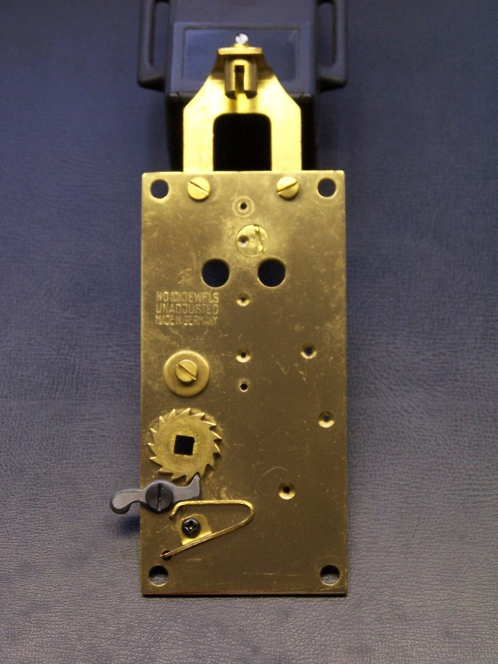

I have a 400day clock of unknown maker(It is made in Germany)It needs a new suspension spring. How do I go about determining the correct spring to order? (some guidelines on sizing ect.)

If you can post some pics of the back plate, someone may have a copy to hand and be able to I.D the clock for you.

i have a copy of the guide as John suggests send a pic of the backplate and I will check it out.
October 19, 2008, 18:23
Peter Cork
Thanks Clive & John for your replies.
I have posted an image of the backplate.
Any information is much appreciated.
P.C.

Peter, the first one I've come up with is a plate style attributed to the 'Associated Merchandising Corp' (Germany)
The diagram is identical to your plate except for some extra text on one side.
Details given are:
(Plate 1012) Page 52.
4 Ball pendulum.
Use .0035" (.089mm) Horolovar Units 19, 20A,21).
Use .0038" (.097mm) Horolovar Unit 27B.
This is listed on page 52 of the 8th edition fifteenth reprint, so there's going to be many updates.

Looks like this movement is illustrated on page 117 of my edition, and is identical in every way. All the data for the spring is Almost the same as listed above with the following exceptions:
Dome Clock: Use .0035" (.089mm) Units 19, 20A & 21.
Square Clock: Use .0033" (.084mm) Unit 20B
I've had a quick shuftie through the book and can't see what the 'Unit Numbers' refer to, so hope someone else can help here.
This plate layout is also used by John Wanamaker & the Euramca Trading Corp plus a few others, so probably manufactured by the same foundry to a stock design and sold to a number of different clock making shops.
