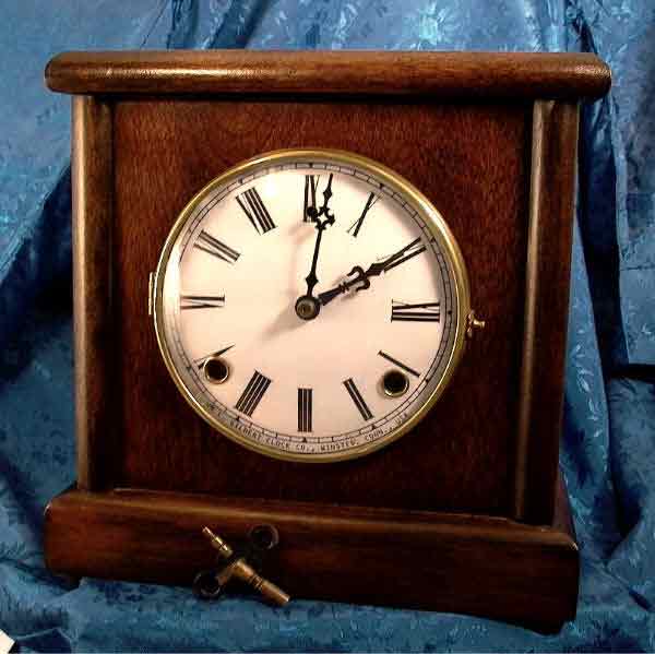

This is a new one for me. I just purchased a Gilbert Mantle clock. Part of the reason was the odd position of the face. It is 90 deg cw to Normal. I have never seen a clock like this. It appears to be factory. What was the reasoning behind a face positioned lke this? Even the wife liked it.
Any comments about this would be welcomed.

Andy KrietzerHey, it's a bedside clock, so you can tell what time it is whilst lying down.
Andy

Could something like this possibly have made it out of the Gilbert factory! Or is it more likely a replacement face that was wrong? How could you put this thing on even as a replacement with out detecting it?
In all honesty I looked at this clock 5 minutes b4 I noticed it.

Tom SeymourThat is very strange!! At first I thought the dial was a replacement and the holes put in the wrong place, but I noticed the lettering is at the bottom of the dial, where it should be.
Can't wait to see what ideas come from this.

Tom SeymourThe dial looks to be new. My guess is somebody's photo shop program got one graphic messed up.

Tom SeymourGreat question Bob. Logic would indicate that unless the movement were installed sideways, which makes setting the beat a trifle difficult, it would strike when the minute hand points straight up. But then...... The dial is one surprise, can't wait to see what is on the inside.

Tom SeymourI must ammend a previous statement. It was pointed out to me that the obvious fix for having it strike when the XII is at the "3 o'clock" position is to simply move the position of the minute hand on the shaft. The shaft is square and the minute hand can go any of four ways.
So...if the dial is a printing error, you could still make it strike at "XII". Can't wait til you get the clock and we get to know .......the rest of the story!

Robert L. BarnesWell the odd ball arrived.
I have posted photos of the face and it appears to be a paper or plastic? A close up of the printing shows the dot pattern and what appears to be a smuge of ink right after the word Winsted.
Also it strikes in the normal XII position. I guess I could give the minuter hand a quarter turn forward and really mess with one mind!
Thank for pointing that out Tom.
The face is held on with 3 screws spaced 120 deg. apart. I had expected 4 screws. Also the paper face is crimped into the brass ring? I am not sure if this is normal for this clock?
I have not removed the face to see what is behind the face? Possible original screw holes? The movement is signed Gilbert. One can see two other movement screw holes in the case that suggests it is not the original movement. A couple of the bush holes were showing black oil around them. This clock was just serviced! I think I read that this is a sign of a dip and dunk type cleaning. Not a total disassembly type service.
Oh well I still like it even though I probably got rocked pretty bad. I did get 50 bucks off when I pointed out to him the problem with the face. But I still paid 100.00 for it.
Ok it's time to quit beating up on myself. It is still a great conversation piece.

Steve CunninghamYour dial is a paper dial, that was replaced. Only someone pasted the new dial 90 degrees off. Timesavers will sell you another paper dial. You can repaste a new one on correctly, and reset the strike, and you'll be fine.

Tom SeymourGreat photos Bob,
I think I would rotate the hand, keep the odd ball dial and, as was suggested, use it by the bed where you naturally look sideways at it.
It is a great conversation piece!

the only thing I can think of is that the dial was made on some program like PhotoShop. The user probably has a file with manufacturers names to use on the perimeter, and files with various number types to use for the various dials. He combines the chapter rings with the manufacturers name and - presto - a new old dial. Only in this case one of the graphics was rotated 45 degrees. Not so easy to tell at first glance when working with a circle.
It was printed incorrectly and we have a mystery clock.

Robert L. BarnesMoses. The two questions you mentioned also have bothered me. The Trademark being in the wrong position ! And him not noticing the face when this was in his collection! I smell a rat! Still I am ok with the purchase and the seller did give me a refund of 50 bucks and also an offer to back out of the purchase. Would I buy from him again ??? Probably not.
My gut feeling is it was a pieced together clock movement and case. The case appears to have been totally refinished and signd of repair inside and extra movement holes inside.

I think i will remove the face tonight and look at the back side of the face and see if any clues are on the reverse side of the paper face. The front side has a ? plastic coating over it. Not sure if it is a do it yourself lamination job on one side or both sides? I also would like to see if there are extra holes in the case from a prior face assembly.
