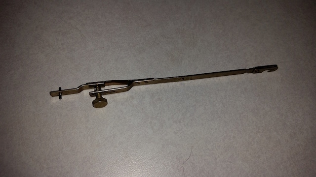

Again I’m new to this but I’m intrigued with the clock. I know the hook is for the spring which I broke taking this arm off. And the pins are for the pendulum. But dummy me I was messing with this screw and it has to be some kind of adjustment.
January 10, 2017, 13:44
Dave Turner
A closer look at your first picture... I see a slot in the pendulum leader. Looks like the screw is to allow raising and lowering the pendulum bob to speed the clock up or slow it down.
The "tick-tock" adjustment is referred to as setting the beat. That's the video I referred you to.
If you broke the small suspension spring that this leader hangs on, it will need to be replaced.

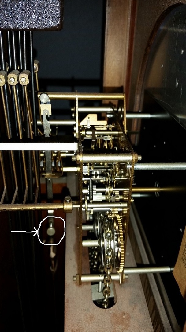

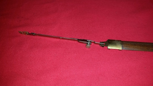

This pic shows the adjustment screw to which I didn't know what was for. I did know about the bottom nut on the pendulum. I’ve been having fun learning about this clock but I am major armature.

John, I think the little thumb screw you are showing holds the suspension spring. If you look at the suspension spring it should have a small hole at the top, the thumb screw fits threw the spring snug just finger tight.

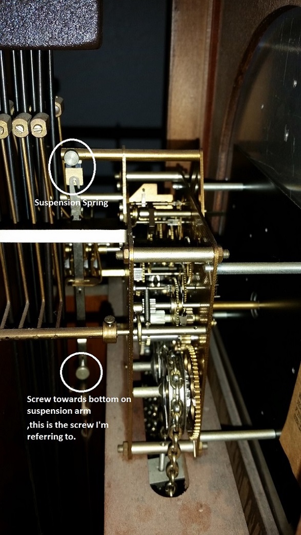

I posted another pic Tim, The screw at the bottom is what I'm trying to learn about.

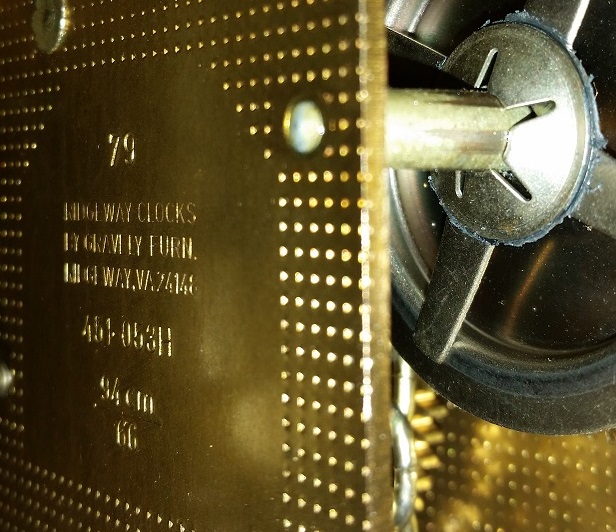

I would have guessed Urgos too, but according to the stamping on the plates, this is a Hermles 451-053H. And the top two numbers are the date. 79 = 1979 vintage. And it does have the auto-beat adjustment. Evidently there was a change in the movements right after 1979, but your's appears to be the later model: Hermles 451-053H
You haven't told us what's wrong with this clock, but so far everything looks okay, (that we can see). I think your suspension spring is okay too.

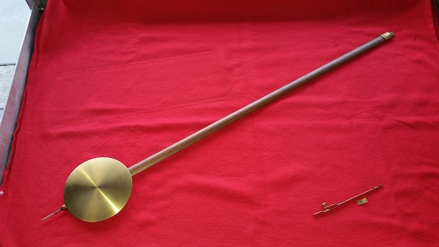

Nice story. Now we get the picture pretty much. For $95 you did well. A pendulum usually has a "rating nut" on the bottom end of the pendulum, which you can turn up or down to regulate the speed. The one shown in your picture might serve the same purpose, but I've never seen one like that. There's a vertical slot in that piece which would also allow up and down movement.
As for the auto beat... if the clock does not tick-tock evenly, as you listen to it, then you can move the leader, the part the pendulum hangs on, to the left or right by applying light pressure, and it will adjust the verge at the top which rides on the escape wheel, to allow even drops and locks on both sides of the wheel. That's where the sound comes from.
You'll get there!

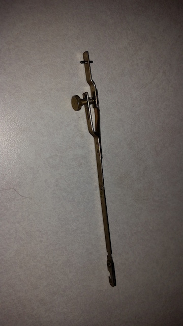

So this pic is what they call the leader then. This is what the pendulum hangs on. But the knob on the leader is also an adjustment?
January 11, 2017, 15:18
Dave Turner
It appears to be, but I'm not sure. When you get home show us a picture of the top end of the pendulum and how it fits in here.

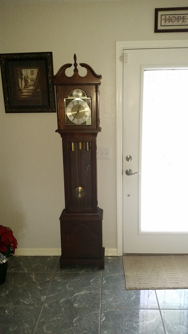

Now that we know more, we would like to know if the weights are in their correct places? Look at the bottom of each weight, there should be a letter denoting their proper place. The weight of each weight is a little different, so facing your clock, L-left, C-center, and R-right. If the wrong weight is in the center the clock will not keep time no matter what you do.

Tim, I'm having problems seeing any marks. Can I go by weight?

I'm not Tim, but chances are your weights originally had stickers, if they aren't marked. And chances are, the heaviest weight goes on the right hand side looking from the front, and the other two most likely weigh the same. If not put the lightest one on the left. Not absolute, but that's where I'd start.
As for the thumb screw in question... I think it has no bearing on adjustments. It just holds the pendulum.

Just adding to Dave's post. I am absolutely positive the lightest weight goes on the left side. This creates a "slow gong" sound when your clock strikes on the hour. Now the other two weights will be about the same weight as each other with one slightly heavier. The one being heavier should go on the right, this creates the faster speed of the hammers when the clock strikes the quarter hour, and of course the last one goes in the center for the time train.
Once you have these right, I would advise you to label the weights for future reference.

Didn't read all the posts, so please excuse me if I answer some questions that have already been addressed. First, as to weights: The heaviest weight always goes on the train that requires the most power. If you have a three train clock (time, strike, and chime), the chime train requires the most power. The time train always requires the least, and therefore takes the lightest weight. The thumb screw on the leader is to adjust the beat. Set the clock up so that the seat board (the board the clock movement is attached to) is level, both side to side and front to back. Then hang the pendulum, and listen to the beat. The tick and tock should be even. If they are not, that is where adjusting that thumb screw comes in. Turn it one half a turn at a time, and give the clock a minute or so to "settle" in.If you cannot get the beat even by adjusting the beat setting screw (which is what that thumb screw is called) then there is a problem with either the leader or the suspension spring. One or both of them may be bent. It is also possible that the "chops (the slotted pin that the suspension spring is attached to) are not vertical. That is least likely, but can sometimes be the case, if the clock was "repaired" by someone who did not know what he or she was doing. First, be certain that the suspension spring and leader are perfectly straight, before trying to adjust the mounting block or chops. If the suspension spring is kinked, there is nothin that can be done but to replace it with a new one. IF the leader is bent, it can be carefully and JUDICIOUSLY straightened. IF you need new parts, you will find a series of numbers stamped somewhere on the back movement plate. Using those numbers, search for one of the clock material supply houses on line, and order the replacement part. If you are unsure what part to order, most houses have very knowledgeable and helpful staff. Call them and explain your situation on the phone.
Forgot to mention. Judging from your photographs, it appears you have a one second pendulum. Once you have the clock in beat, you can then adjust the rate by moving the pendulum up or down with the nut at the bottom (Called a rating nut.)
Also, your photographs do not show it, but there should be a thumb screw with a straight turned portion, that goes through the hole in the upper end of the suspension spring. That screw will only go in the mounting block from one side, and must be tightened finger tight, but tight enough that the suspension spring cannot "rattle" in the slot.

David is right about the most weight to the chime side John, weights for your model (Hermle 451) if I read the post correctly should go with the heaviest ( I think 6.6 lb) to the chime side. The other two weights should be the same at I think 4.7 lb and go on the time & strike trains. This info is for a normal pendulum and bob, if you are running a later "lyre" pendulum or have a second hand on the movement it is different again.

I think you said you was hoping for your suspension spring Friday. After looking back at your great photo, January 11, 15:14 It might be a good ideal to straighten the bend in the rod were the thumb screw is and start fresh. Then use your beat regulator knob IF NEEDED. Take your time and good luck!!!

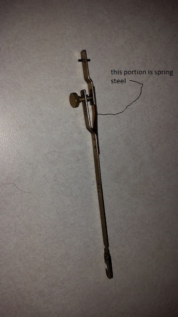

Rim, I don't mean to be disagreeable, but those two bends nion the leader appear to me from the photos to be correct. The leader is made with a offset, so that when in beat, the suspension point is nearly in line vertically with the suspension spring. Of course, since there is one offset, there has to be a second one to counteract that. If you look closely, you will see that one is greater than the other,. That is so the beat adjustment will bring the two ends more nearly in line.

I see what your talking about now David. John said he "cranked" on the knob in a early post. If he backs the knob out do you have to bend the leader back some, or does it have the spring "worked" in the bend? Not real sure how that works. Thanks for the correction.

It will move back on its own. The portion of the leader that the adjustment screw bears against is spring steel. He should start with the beat adjustment screw about halfway in, so he has equal adjustment in either direction.
