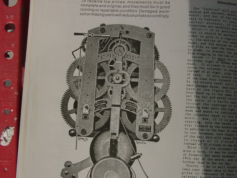

Tom SeymourCurl, Thanks for the heads up on that seller. I went back and looked at the clock again. This time I looked more carefully at the movement and the one shown in the picture is NOT the one that would have been used in a Fashion.

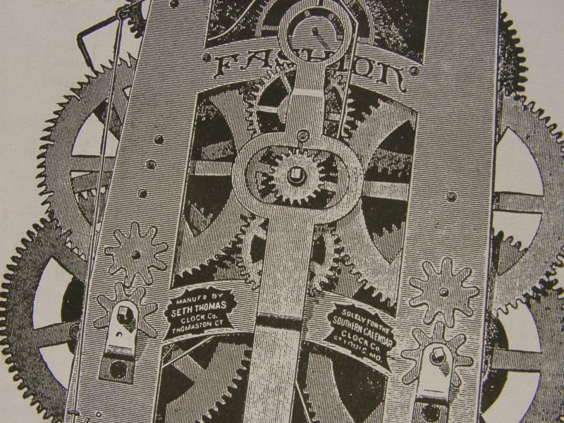

Tom SeymourThe time movement is definitely not original. That movement would not be used in a Fashion.
The one in the photo looks like a 44E. The Fashion Movement is an 86 type and would be marked "Fashion" , "Seth Thomas" and, "Southern Clock Company" that produced the Fashion models.
I can't see the calendar movement well enough to tell. But based on everything else, I would suspect that it is also a repro.
