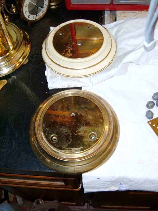

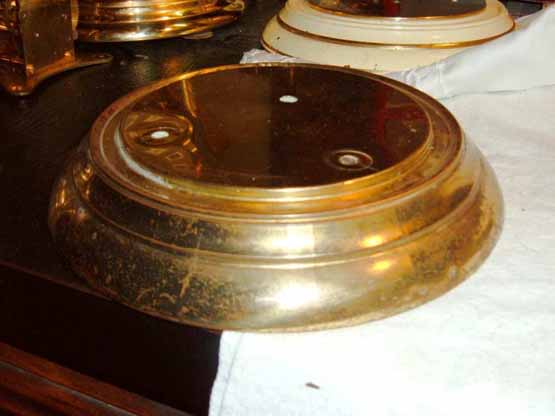

September 13, 2007, 18:11
Stephen L. CareyLidell thought it was good idea to attach photos of the project, this is the base. As you can see it is very much damaged.
Stephen L. CareyAnother photo of the base

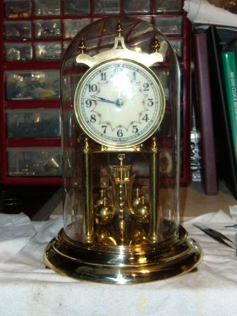

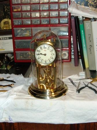

September 23, 2007, 21:55

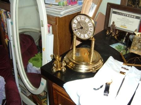

Stephen L. CareyMy little project is complete. I finally found a base and the rest is history. I need a spring guard, but other than that she is working beautifully.
September 23, 2007, 21:56
Stephen L. Careya little closer

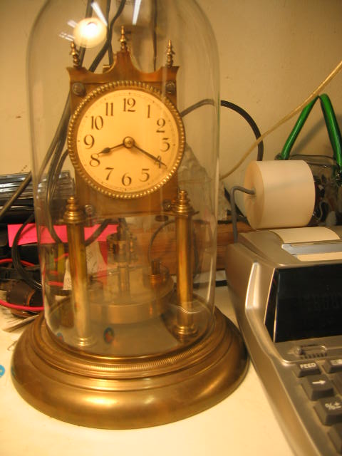

David AbbeCan you do the same for my 110 year old? It runs +/- 10 min a day, but it sure doesn't shine like yours. Seriously you did a beautiful job, especially if this is your "first".
September 23, 2007, 23:39
Tom SeymourGreat job Stephen!!!!   What is your next project??
September 23, 2007, 23:53
Stephen L. CareyDavid this is my first 400 day clock. It was fun to do. If that other thing, you know, work, job etc had not gotten in the way it would have been done sooner.  This one is running a bit fast, I need to give it a few days to settle in, and then set the beat again.  Oh, nice clock.  Thank you

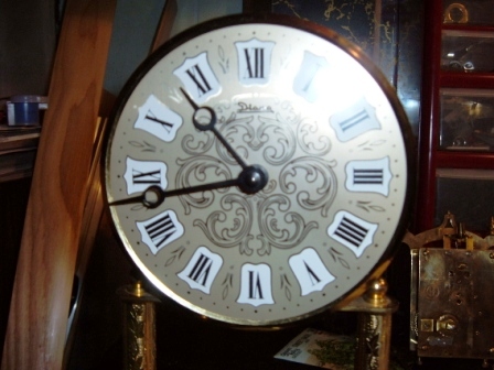

September 24, 2007, 00:05
Stephen L. CareyI have another one of these and several watches to repair ( replace the battery and clean) The next one is below.
September 24, 2007, 00:06
Stephen L. CareyThe next one above and here
September 24, 2007, 00:07
Stephen L. CareyNext one again

David, nice disc pendulum model!
