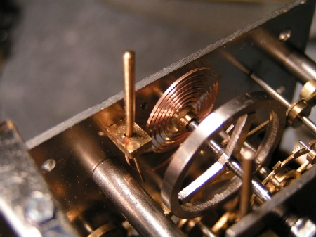

I feel quite comfrtable with the pendulum escapements, but here I have a Junghans carriage restoration project for a client. I'm having problems on exactly how to set it to get the proper running and speed adjusting capabilities on this spring. I have not pinched the adjustment "leg" tight on the spring as of yet.
I feel confident that the end of the spring needs securing to properly align it perfectly. But then exactly do I set up the speed adjustment?
Any thoughts and help would be greatly appreciated.

This is a photo, next one to follow.

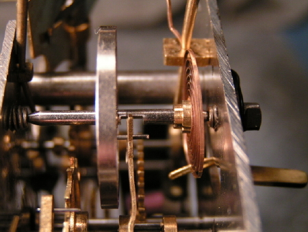

Moses Gingerich
Junghans Hairspring
November 06, 2005, 14:49
Moses Gingerich
Second shot of the hairspring.

Moses, I am also no expert on those "coily" things, but rate is set close by pinning the end and fine adjustment is with the adjustment leg which should not be pinned tight on the hairspring. Make sure that the hairspring is running in a straight plane and that the coils do not touch. I am sure that someone else will show up and make this more understandable

I am not familiar with this particular clock,but for some basics,with no power on the train make sure the impulse pin is centered in the slot of the fork.If not, move the collet on the staff.
The hairspring should be pinned tightly in the bridge and loose in the regulator.If the hairspring pin has been removed,look for a spot where it was originally pinned.There is probably a short straight spot in the spring.The spring should "breathe" in the regulator pins.Closing the egulator will speed the clock up and opening the pins will slow it down.
The balance should have ample shake in the cup screws.The balance pivots should be ground to a sharp point and polished.
I'm sure others will have other things to add to this.
Good luck.

Thanks so much for the expert comments on the coily things! I knew someone would understand me.
I followed Sir Tom's advice and the spring seems to have a good shape now, and it started functioning quite well until the big coily thing stopped supplying power...see now, how do we wind it???!!
And it keeps time with a few small adjustments of the regulator. I thought the reglator needed to allow the spring to "breathe"...and it does.
I believe I'll go back and polish the pivots per Sir Julian's specs. I discovered the alarm brake just won't function properly so I'll have to disassemble it again anyway.
