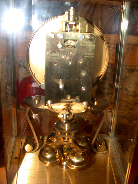

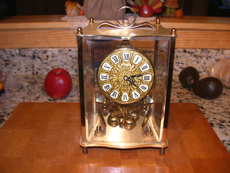

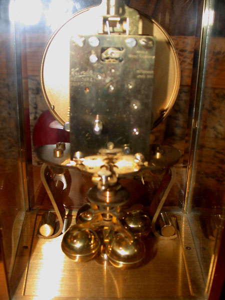

I picked up a Kundo Kieninger & Obergfeli clock which needs a suspension spring but I don't know the model in order to order the correct one. I can't find a model number or reference for this clock.
Does anyone know the model?

Ernie,
Can't be positive without a good clear image of the back plate, but I'm pretty sure it's a plate 1407A. And uses a .0023" (.058mm) spring.
I don't know what model it is.

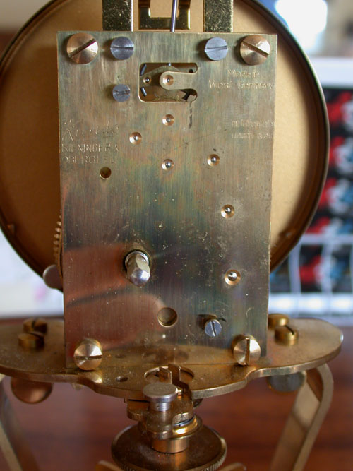

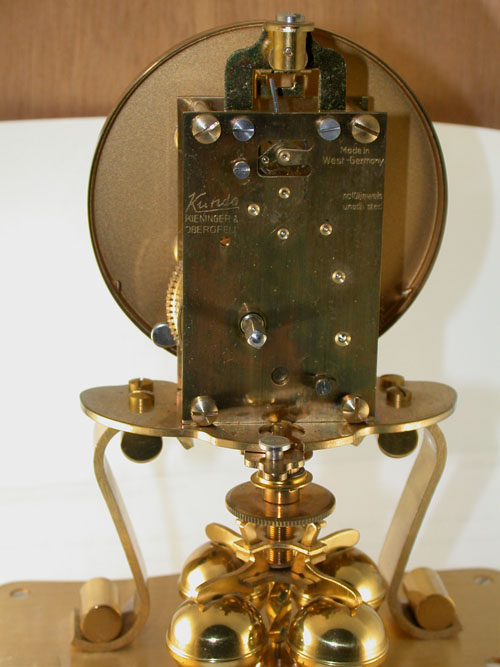

Dave, I have a few more pictures for you to look at.

Dave Turner
Good Picture!
Kundo Junior 56
That's a plate 1406H according to the Terwilliger Repair Guide.
It also uses the same suspension spring. .0023" .058MM And indicates a 4 ball pendulum miniature clock.
The 5E is the recommended spring. (Horolovar)
