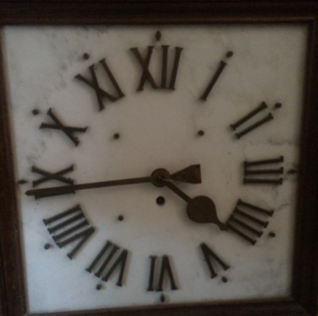

Any idea where a clock like this would have spent it's life in service?
This thing is big, about 20" X 20" and weighs about 40 pounds. All the brass numbers and markers are in place with original hardware.
The mechanism is in great condition.
Even though this is a Fusee, it doesn't seem to be that old to me.

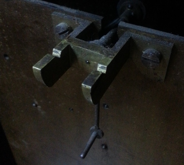

Pendulum mount
If anyone can steer me to parts or illustrations for me to build parts...

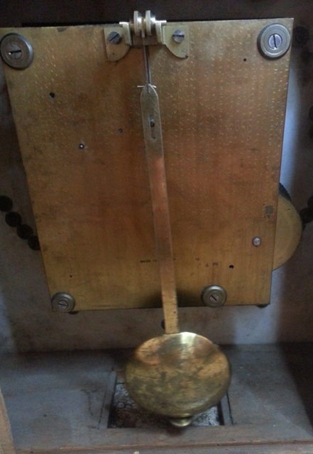

I found a Hershede suspension spring bracket through Time Savers and was able to work it down on my lathe to fit this clock.
I used the old auction photos to figure my spring lenght. (the original bracket was there when I bought the clock but was lost by the auction house in delivery.)
As soon as I hung the pendulum, the clock took off running. I backed off the weight adjustment two turns, shimmed one side of the case up 1/8 inch and she is keeping time like a champ.

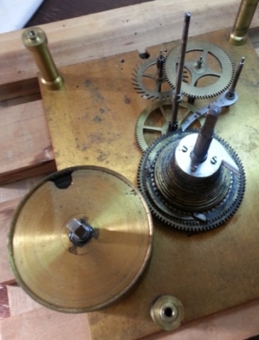

Wow, after plenty of years of oil and a few years in the back corner of the barn, she was a bit overdue for some TLC
January 15, 2015, 19:57
Paul D. Trombley
It took me a bit to figure out how to hook and unhook the chain and figure out that the locked gear on the front was an assembly/disassembly aid to pre-load the main spring... but other than that, pretty straight forward.
