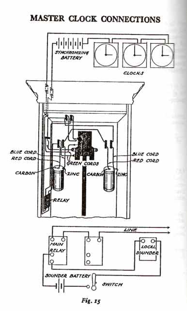

Here is the Western Union hook up for one of these and this has master clocks run timed from it. This diagram show it real well. I worked for the Northern Pacific for many years and the stations had these clocks that were set by Western Union. The guys compared their time and corrected as needed.

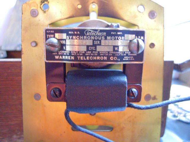

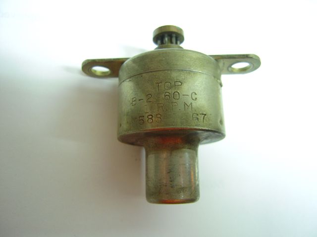

Michael O'BrienSo I have discovered my clock is powered by a very old Telechron type B2 rotor and coil. I spent a good portion of yesterday looking for an expert Telechron rotor repair shop. The first shop wanted $120 plus shipping another wanted $75 plus shipping. Then I found one in my own back yard that trained with a Telechron expert and owns the factory equipment and drawings. Brien is the owner and charges $65 (including) return postage. Brien said the rotor will be rebuilt to factory specs. The turn around time will be 3 to 4 weeks.

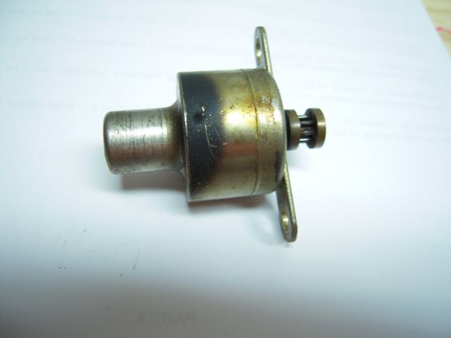

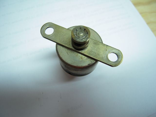

March 09, 2010, 12:08
Michael O'BrienBottom of the rotor. Brien said the soot is very common and a dead giveaway that the rotor needs to be rebuilt.

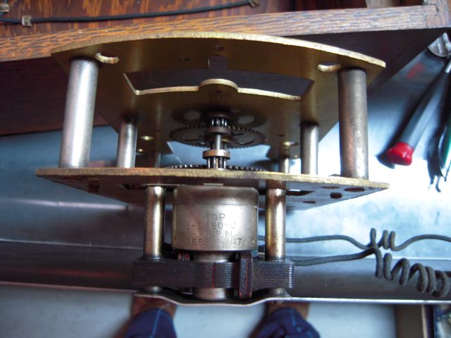

March 09, 2010, 12:09
Michael O'BrienFront of rotor. He will remove the gear and then reattach it after the rebuild. The long bracket supports the front of the rotor to the movement.
March 09, 2010, 12:11

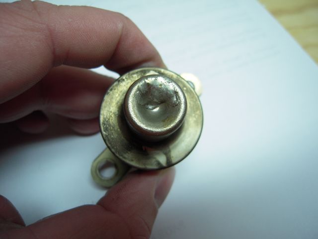

Michael O'BrienBack of the rotor. Brian said on the very old rotors like mine they were filled with oil in the back after being built/sealed. That is why you see the solder.

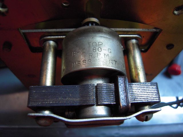

March 09, 2010, 12:24
Tom BrownMike
Just curious, I can't read the voltage listed on the tag due to the glare. What does it say the voltage is?
Great you found a guy their to do the work, I would like to see some photos when you get it fixed.

March 09, 2010, 15:15
Michael O'BrienI will keep you posted.
Tom, The voltage is 110 on the tag.

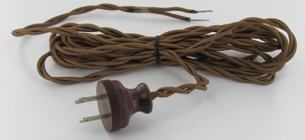

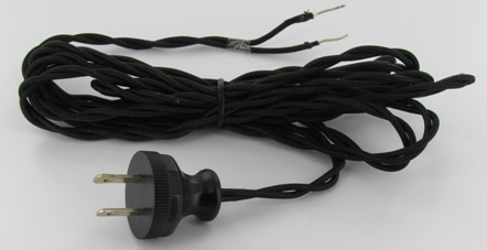

Michael O'BrienI am getting ready to order a cord for the clock.
Black
March 30, 2010, 18:28
Michael O'BrienTwisted fabric cordset with antique style plug.
What color do you think I should get?
Mike
