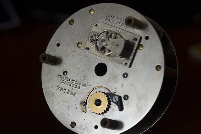

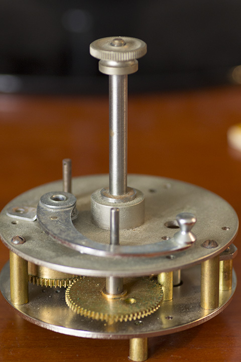

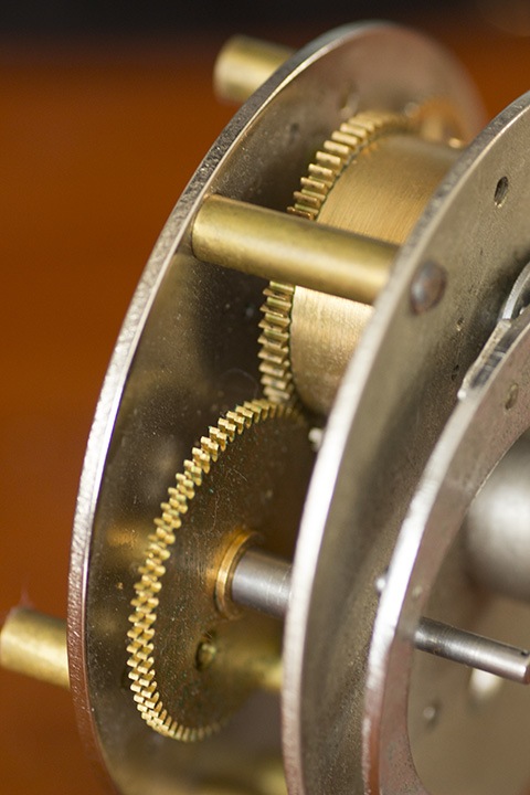

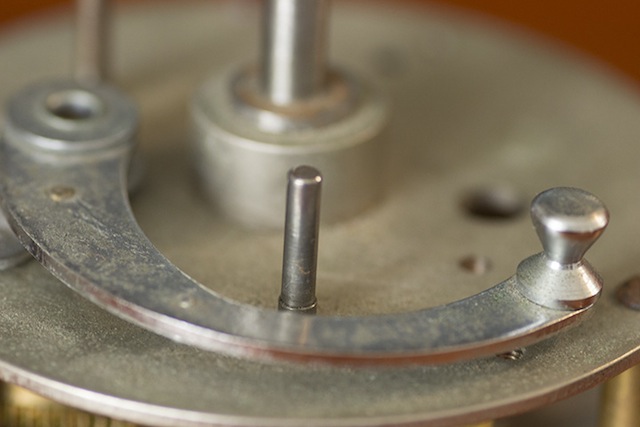

Someone gave this to me a few weeks ago and I can't tell what it was used for. It is apparently geared to run eight days. It has a Swiss platform escapement with Breguet hairspring and Incabloc shock protection. The center post with thumb screw looks like it's for holding some kind of cover in place. It has a lever for hand winding. Also a set of anti-backlash gears driven from the MS barrel. 2 shafts protruding from the top plate: 1 is from the anti-backlash gearset and the other from the pinion of the 2nd wheel.
What the heck is it?
Thanks!
William

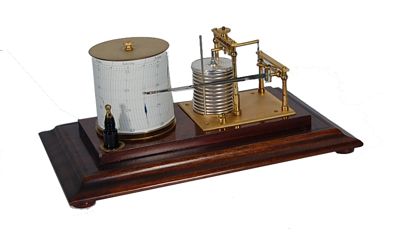

Ok. I think I just figured out what it's from: I believe it's the drum movement from a vintage recording barograph. This makes sense because the center shaft is finely machined to accept bearings inside the drum.
William
March 24, 2015, 12:41

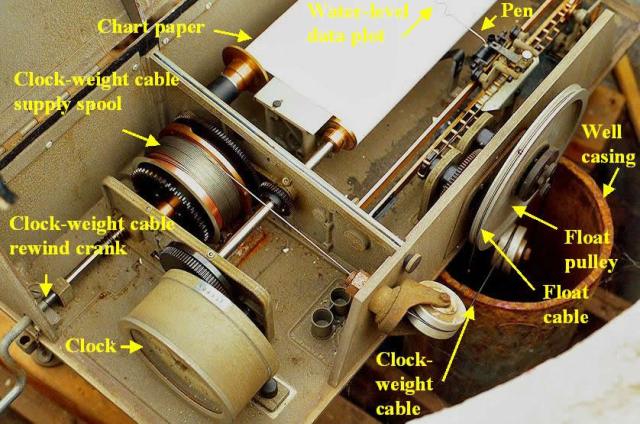

Paul D. Trombley
This one is close, but not quite... Same general idea though... the devices are designed to measure data against time and provide a written record.
