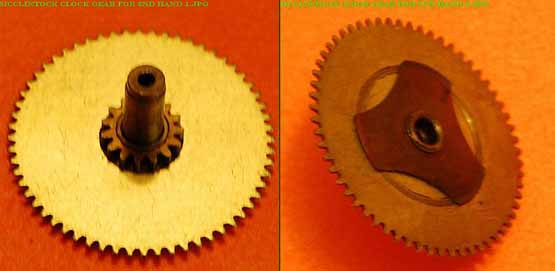

My McClintock clock works great except the second hand won't turn consistently.
This picture shows the second hand gear on top (still attached to the second hand) and the hour hand below.
I can see that the gear shows a wear pattern circle that indicates that the 3 pronged retainer has been turning against.
I've never had one of these apart and don't know how to get this one apart.
Can someone advise me how to proceed?
Should the retainer and the gear be locked together or should they turn?
How do I take it apart to clean it?
October 26, 2013, 13:34
Dave TurnerHere's another picture showing both sides.
The large flat gear turns somewhat freely on the shaft. (And I don't think it should?)
How can I tighten it up?
October 27, 2013, 15:08
Dave TurnerDidn't get an answer here, so I experimented a little.
I wrapped one turn of dental floss under the 3 prong retainer to tighten it up. (For anyone who might experience the same problem.) I'm sure this is not a proper repair, but it works!
Clock now working fine and keeping good time. Not bad for a 1946 clock!
