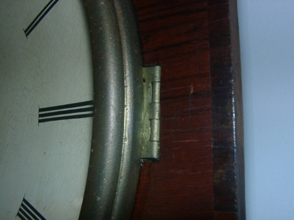

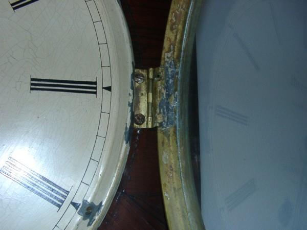

Tom SeymourCharlie,
The best I can do is a picture of a Jerome short drop octogan. On the outside the hinge has been set into the surrounding wood. However, when you view the inside, yu will see this is not a factory installation. The screws are mismatched and the solder job on the hinge is not the greatest. The glass and bezel do sag a bit when opened. I don't know of too many that dont. I don't know if these picts will help, but thought I would throw them into the conversation on how to do this correctly.
Tom Seymour
NAWCC# 41293
IHC# 104
IHC Executive V.P.
October 27, 2003, 12:31
Tom SeymourOutside: Notice the hinge is countersunk into the molding.

October 27, 2003, 12:32
Tom SeymourOn the inside you can see that this is not how it came from the factory. This is how I recieved it. I don't know how old the repair is.
What is the setup on yours like?

October 30, 2003, 15:39
Charles R. SidesThanks for the pics Tom. Mine hinge is similar, but the rear half is soldered to the back of the dial pan !!!
It really helps to see pics of these things.
