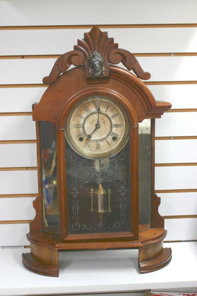

I am looking for case parts for the clock below. In Ly's book of Waterburys, the "Oxford" looks very close. Would anyone happen to know where I might find a case and or parts for this case?
Greg
(picture edited for size to avoid scrolling)

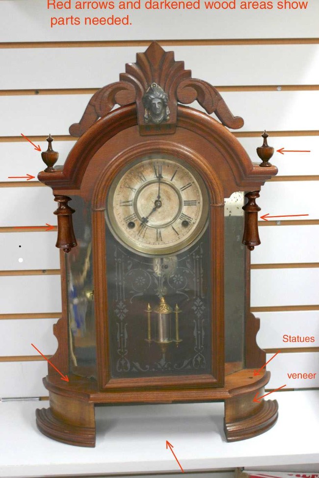

Greg ReevesWould anyone happen to have close-up photos of the bottom center(wood) and of the statues?
Greg
February 09, 2005, 11:56
Andy KrietzerSeems like I saw the statues in LaRose or Merritts catalogs.
Andy
February 09, 2005, 21:39
Tom SeymourStatues are $7.50 each from Merritts, page 99 of the 2004 catalog.

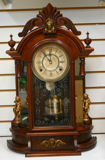

Greg ReevesFinished! The case work was done locally.
July 19, 2005, 12:41
Tom SeymourGret job Greg!! Fantastic restoration.
July 19, 2005, 16:05
Kevin PestorLooking good Greg, great job on the clock, is it yours or a customer,s.Just wondering.
July 20, 2005, 07:49
Greg ReevesIt's a customers. The case restoration complete...cost $275.00, which I thought was very good. The guy used old wood for the replacements. I don't really care for the "cupids", but I'm very pleased. If anyone would like the name of the guy...I would be happy to recommend him. It took almost 3 months...but he's like the rest of us...works alone.
