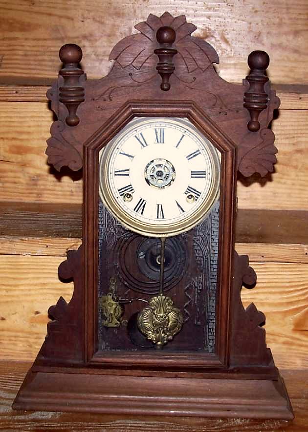

I have this Ingraham kitchen clock that I am getting ready to restore. The hands are missing and most of the painting on the glass has been rubbed off. Can anyone give me an idea of which hands and glass decoration I need to find?

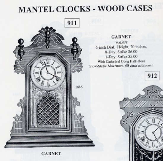

It appears you have the "Garnet", shown here in Tran's Ingraham book.
The hands are the pierced spade hands, and are carried by R&M Imports, LaRose, Merritts and probably Timesavers as well.
The glass styles varied. The one shown in the catalog is not the only style to be original to the piece. Anything Ingraham carried would do.

I see that Timesavers stocks the glass pattern shown in Ly's book. I will order it and the hands from them. This project is coming together nicely.
