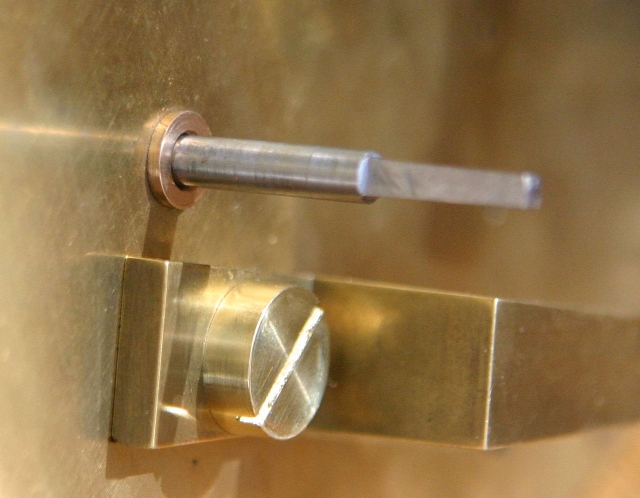

Peter BlunsdonI've heard it said that Bronze bushes are cosmetically undesirable and presumably lower the value of a piece.
Personally I like to give a pivot the best running conditions possible.
All pivots wear as the bush, brass or bronze, picks up dirt and grinds away the pivot.Maybe bronze being harder picks up less and wears the pivot less, but I'm not sure if this is proven.
The color difference is striking however. Here's a pic for you to judge.
Peter
