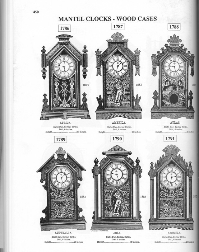

Tom SeymourBruce,
I could not find your exact model, but I think there is enough information to get pretty close to the date.
The clocks on the page below are 1883. This is consistent with the marking on your clock. The Ansonia Clock Co, NY dates from 1878-1929.
I was common practice for kitchen clocks and black mantles to mix and match pieces. The clocks on this page have many of the same elements as yours. I would guess yours is dated a bout 1883 as are the others on this page.
hope this helps.

The clock looks very close to the Arizona model with a few tweaks.. Thanks again
