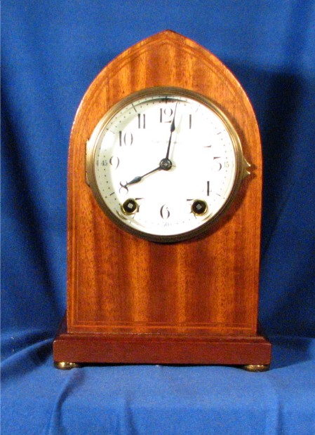

January 18, 2006, 21:57
Tom Seymour
Seth Thomas Mini Beauty
This clock is part of the Will Roseman collection that is visiting my shop at the moment.
While this looks pretty much like an average clock at first glance, a closer look makes is a real treasure. The detail and quality is a cut above.

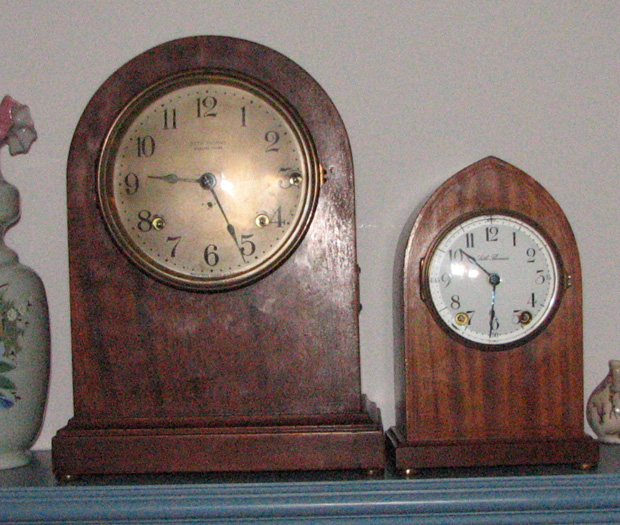

January 18, 2006, 21:58
Tom Seymour
One of the real attractions of this clock is its size. From the first picture you can't relly tell, but here next to a Seth Thomas sonora you can see that its small size, only 9.5 inches, makes it quite attractive.
January 18, 2006, 22:02
Tom Seymour
The dial is porcelain and the glass is convex and beveled.

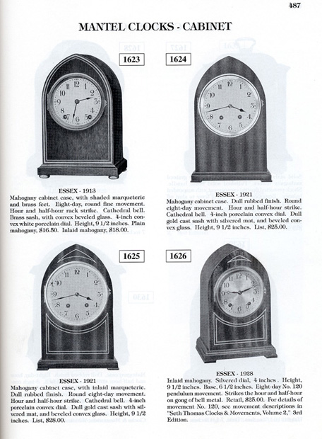

January 18, 2006, 22:04
Tom Seymour
It appears to be the Essex model from around 1913.
This picture is from Tran's Seth Thomas book.

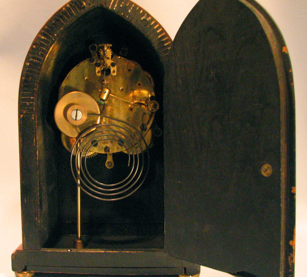

If there is interest, I will take some pictures of the movement when I get it out of the case.

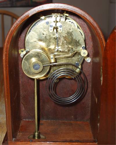

January 18, 2006, 22:08
Tom Seymour
The movement is a nice compact little round time and strike movement. It appears at first that it has springs in barrels, but actually they are in round "boxes".

Here is an update on this cute little clock.
It is perking away keeping great time.
March 15, 2006, 21:28
Tom Seymour
back.
March 15, 2006, 21:29

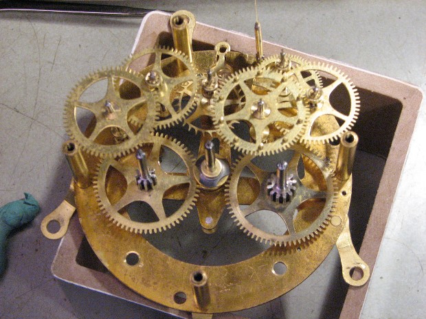

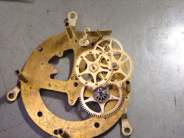

Tom Seymour
Strike train
Tom Seymour
both trains
Joe, this one does have the bar type spring riding on the center post. I would imagine it is, as ws mentioned, to keep any play out of the minute hand as it changes from before and after halfway points around the dial.
