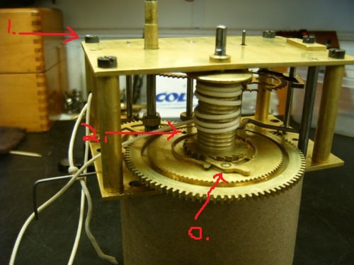

Richard RomeroEugene,
Hopefully Eddie is correct and you just need to engage the ratchet (0.) shown below.
The #2 regulator is one of the easiest clocks to work on and should be easy for you to clean and oil as its parts are much larger than watches. Earlier this year I cleaned, oiled, and fixed my #2 which was purchased not running. First remove the hands and dial then the movement can be taken out of the case. Remove four plate screws shown (1.) in the picture. After removing the plate all the gears can be taken out as well as the winding gear and spool (2.) assembly.
December 31, 2011, 16:55

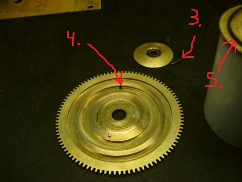

Richard RomeroAfter the spool assembly is out it needs to be disassembled by removing the pin (3.) next to the part shown near it in the picture. Once apart you will see the spring (5.) that provides the maintaining power. One end of the spring goes into the hole (4.) of the gear shown and the other end fits into the hole on the other piece (2.) shown in the above picture. When assembled properly you can feel the spring action by holding on to one piece and moving the other. Getting this assembly put together properly is what a local clock maker told me is the most important step that often isn’t done correct.
After cleaning all parts reassemble and oil. The spool assembly needs to be oiled as it is being put together. I am unfamiliar with clock nomenclature so some of the parts might not be named properly but this should give you a general idea of what’s involved.

Bill CarlsonNice photos Richard. Very clear!!

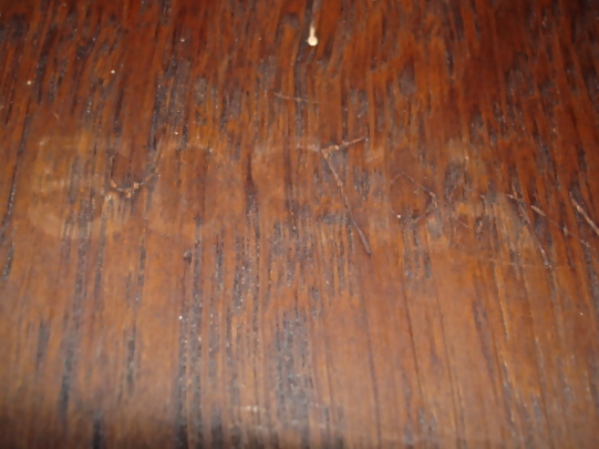

And for anyone who doesn't know this there should be a date of manufacture code on the back of the case, probably quite faded. Mine is 5091A which when reversed dates it to January of 1905

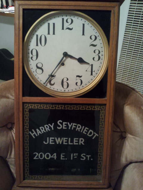

Jon HartingI just wanted to add my 2 cents and show you all a picture of the Ingraham clock that Harry Seyfriedt had hanging in his East Los Angeles jewelry store. From what I have researched, he and his two brothers were all jewelers in So Cal. I "rescued" it in 1961 from a flooded basement that was located about two blocks from the address on the clock (that address is a dilapidated, run down two story building now). The location was the basement under the stage at the Hollenbeck Masonic Temple on the corner of First and Chicago Streets. It was completely under water when I found it. My father refinished the oak case and I cleaned and oiled the mechanism. Fortunately the original painting on the glass wasn’t affected by the immersion. The only time when the clock hasn’t been running was when the mainspring broke around 1983 and I had to replace it. It has been very well cared for since I found it and is still keeping RR watch time on the wall of my home.

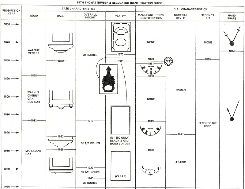

Richard RomeroDonald,
According to the chart provided below the ST #2 was offered in Oak, Walnut and Cherry earlier on then later only in Mahogany and Oak. If you notice at first the clocks were only offered in Walnut so it seems the darker models will be older. As Eugene explained these clocks are accurate due to a weight being more consistent than a spring and like him I also wind the clock every Sunday. Lorne explained the dating system above and if memory serves me right I don’t think there are serial numbers per say. There are several minor variations of the movement which should coincide with the year. I’m sure there are books to date the clocks but the chart below should get you close.

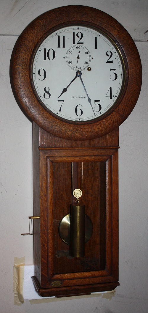

Richard RomeroHere’s the #2 that now hangs in the living room. The picture was taken while the clock was being fixed in the laundry room. According to the chart above it was made about 1922-1929. Also, these clocks have a heavy pendulum and are a joy to listen to at 80 beats per minute.

Jon,
Nice save on the Ingraham clock it looks great.

From what I have read, you are correct, there are no serial numbers on these clocks. The dating system I mentioned was supposedly discontinued around 1918.
This is the date on mine 5091A indicating Jan 1905 but I had to look very hard and get the light angle just right.

Donald HawesThanks again for all the info. Richard, Iwant one just like yours.
