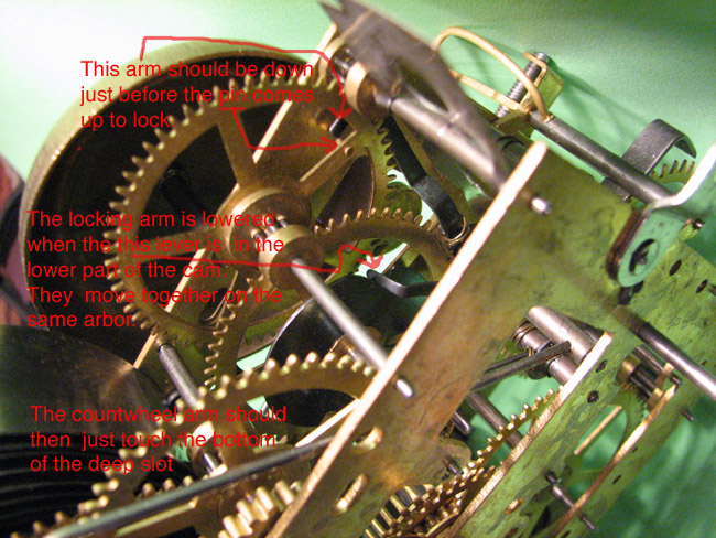

Tom SeymourThere are three elements on the same arbor in most of these movements. They move together. Be very careful when bending any of them, because bending one affects the position of the others.
The key to locking is to make sure that the wheel with the cam is in sync with the wheel with the locking pin. The lever that rides on the cam should be just hitting the lowest part of the cam when the locking pin is approaching the locking lever.
I have tried to explain with a picture.. hope this helps.
If all that is in order, and it still doesn't lock, then look to see if someone previously has bent the wires. The arm in the countwheel should drop into the slots without touching either side of the slot. Often I have gotten a clock where the strike won't lock and the problem is that that lever was coming into contact with the side of the slot, so the locking arm ( they are on the same arbor and move in unison) could not drop far enough to lock.
It is like detective work sometimes. check it over first. Bend as a last resort. Sometimes the helping spring is the last needed item.

Thanks for the photo it helped a lot. Books and drawings are great but photos are the iceing on the cake! I was a bit off on the timing of the warning stop pin so a quick adjustment of the pinion took care of that.
As I told Larry I added an assist spring to the count lever arbor and it works every time.
