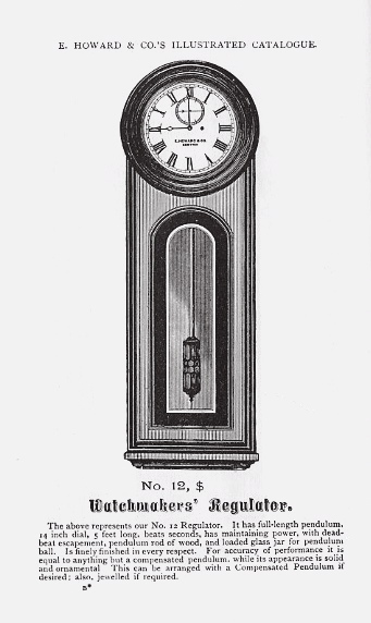

I dug deep and found a picture of the pendulum...
http://www.chaywood.com/howard12.jpg
It looks to be filled with shot...
Charlie

Charlie,
This is probably similar to what you saw in your reference book. It is from the Howard Catalogue. In reading through the additional information in the book, there is no reference to what the "loaded jar" was loaded with.

I ance had that clock. It's called a Watchmaker's Regulator. In this case, the glass jar would have filled with lead shot. The adjustment rod runs all the way through the jar, so mercury would have leaked out.
