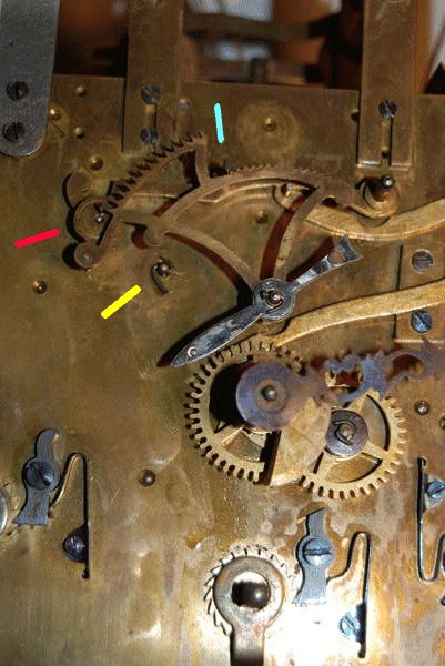

I am wondering if anyone has seen a movement like this before. I have been observing it work so that I can get it together after it is apart.
It has a lot of levers and cams than I have see before. I can't see a reason for the duplicate rack. You can see a pin under the gathering pallet that lifts the upper rack so it can move.
Let me know what you think.
Rick

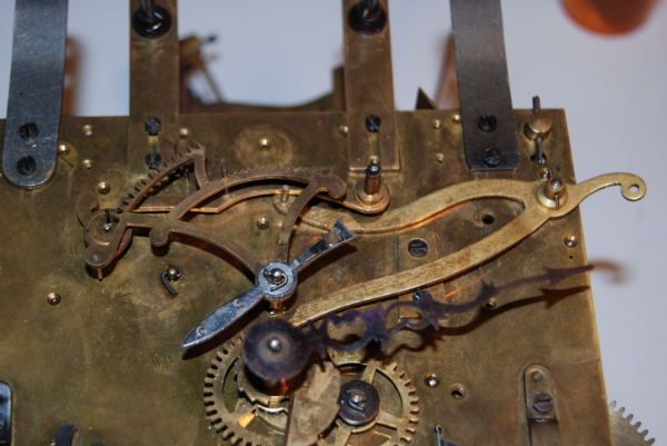

Here is another view.

How many strike hammers are there, one on each side or a different arrangement? Since it appears to have three trains one of them must drive a quarter strike of some sort. The ratchet wheels, their retainers, the clicks, and the click springs look French, but the spring loaded pin on the rack where it rests against the snail and the motion work wheels don't look like French work. That post just below the rack with a bent pin through it looks strange, does it protrude from the plate far enough to be the arbor for a second gathering pallet?
November 12, 2007, 07:08
Greg Reeves
Does it have a makers mark/name?
Can you identify the parts I've marked?
Are the racks "one part"?
greg

I have not had the movement apart but it does say Germany on the back. I can take more pictures tomorrow night after I get back home.
I will also validate the parts you have marked but I believe I describe them correctly below. I have studdied this movement for awhile now.
There are hammers on only one side of the movement, the right side as we are looking at the front of the movement.
The two racks are connected.
Under the gathering pallet there is a pin that raises the lever attached to the strike movement - on the right side of the movement. It is the lever that has the curley cue on the end on the right side of the upper picture. I don't know the name of the lever - I'm sure it must have one - but the bottom if it rides on the cam attached to the minute wheel.
The gathering pallet is shaped like a comma rather than a kidney and the pin on the underside raises this lever at the same time that the upper pin on the gathering pallet raises the normal rack. This lever has a pin - you marked it in blue - attached to the lever that disengages the upper rack at the same time as the upper pin is moving the lower rack.
As I recall the yellow mark is pointing to the cam that goes straight through to the back of the movement and serves as the pinion for the hour strike lever.
The red mark points to the gathering pallet, which is comma in shape and at rest is in the same position as a comma.
I do appreciate the input. I wish I could get good pictures of the cams and levers on the inside working.
Rick

Sorry it has taken me so long to reply but I am now back home. The 3rd train, on the right in the images, does control the Westminister Chimes. Note the upper lever that has 2 arms.
When lower lever, Purpleline, that rides on the snail raises up on 3 of the quarters it does not raise enough to lift the pin circled by the light blue circle so the racks do not move. This pin will raise te bar highlighted by a pink line that controls the pin on the upper rack in red and end of the lever in yellow. On these three quarter hours there will only be progressive Westminster chimes.
On the 4th quarter, the hour strike quarter, the snail raises the purple lever up to the point where the red pin on the upper lever allows the rack to fall. On each rotation of the gathering pallet the end of the upper lever, circled in yellow, is raised by a pin on the back sside of the gathering pallet which raises the pin that constrains the upper rack. This allows the rack to move in syck with the gathering pallet.
Pictures will help.
Note, this image is post cleaning.
Rick

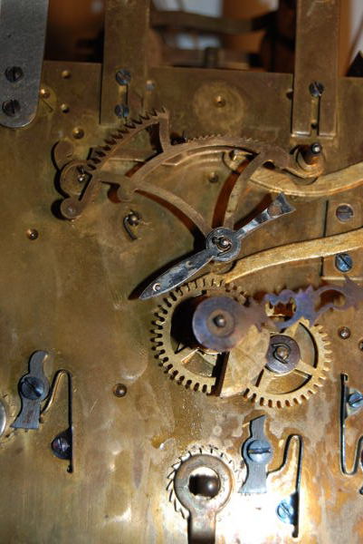

Note the tear drop shaped gathering pallet stopped by the rack pin, circled in red.
November 19, 2007, 01:54
Richard Morey
If you look closely you can see the pin (circled in light yellow) on the underside of the gathering pallet, blue arrow, lifting the end of the lever that raises the pin to allow the rack to move.

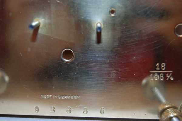

You asked for any other identification marks, here are the marks on the back of the case.

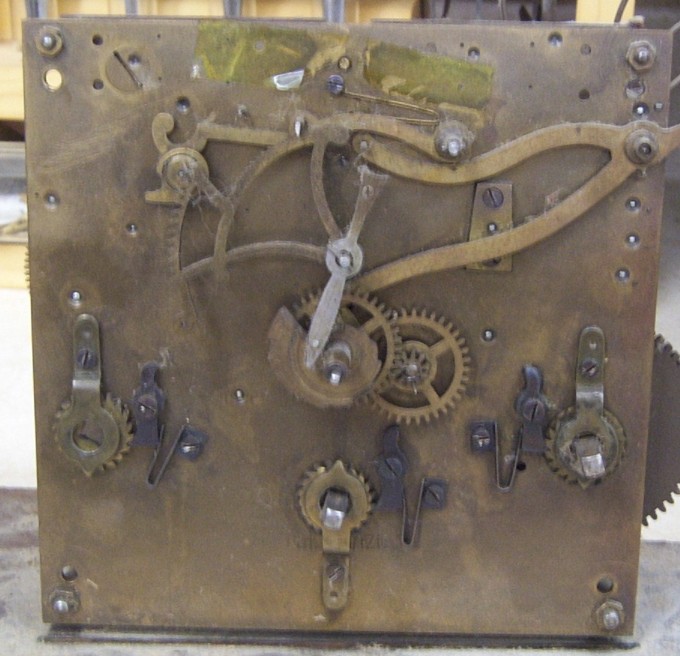

A shot of the interior of the front plate.
