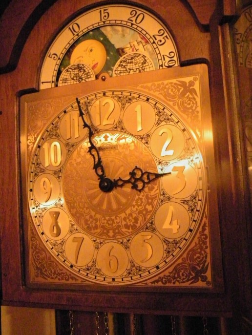

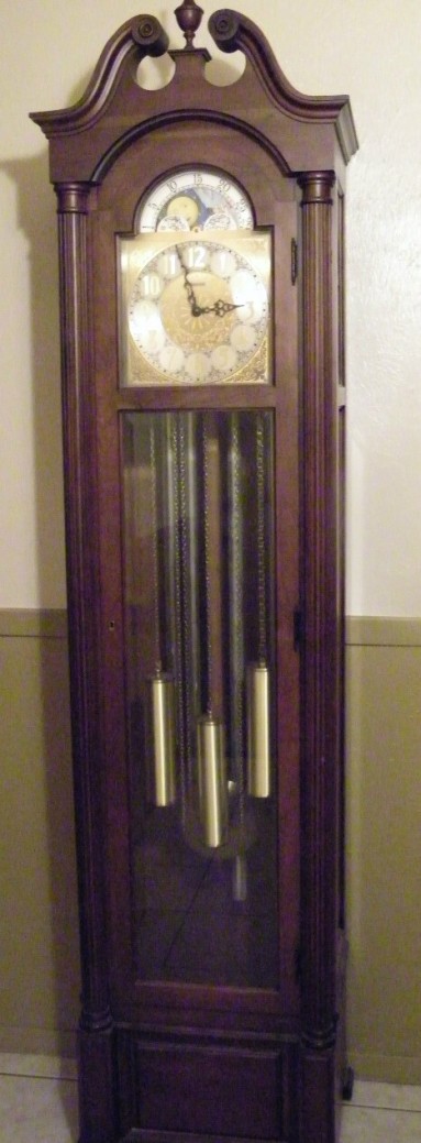

This is the grandfather clock. It was made by the Barwick division of Howard Miller which I have found are the less expensive clocks made by the company.
September 01, 2010, 23:33
Mary Ann ScottThe dial....

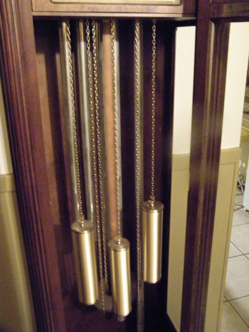

Mary Ann ScottWeights and pendulum...

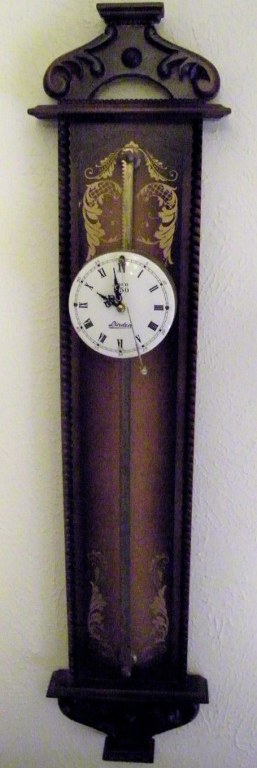

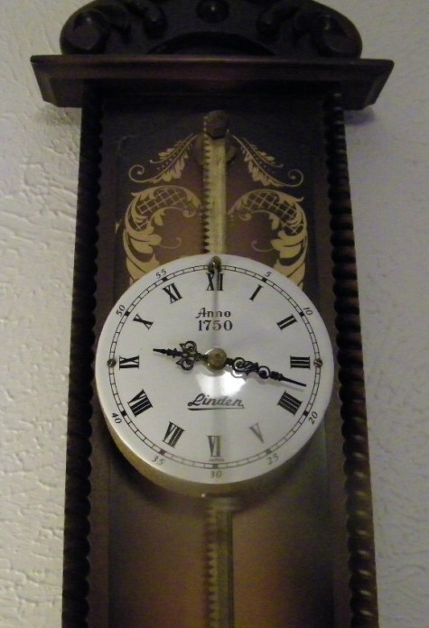

Mary Ann ScottWe always called this one the "saw" clock. The dial is marked Linden and it was made in Japan. I always liked this one as a kid.
September 01, 2010, 23:35
Mary Ann ScottClose up of the dial...

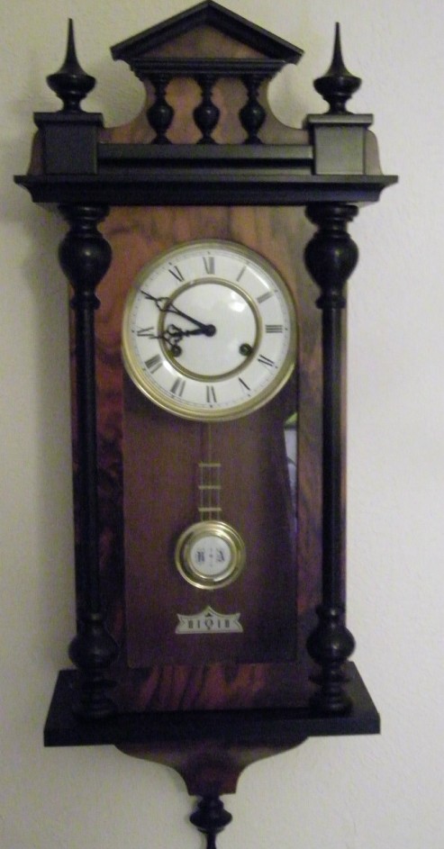

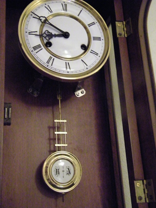

Mary Ann ScottI call this one the Venice clock. I can't find any markings except R A on the pendulum. My mother put a note in it that said they bought it in Venice in 1977 and paid $175.00 US.
September 01, 2010, 23:40
Mary Ann ScottThe dial and pendulum...

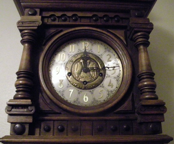

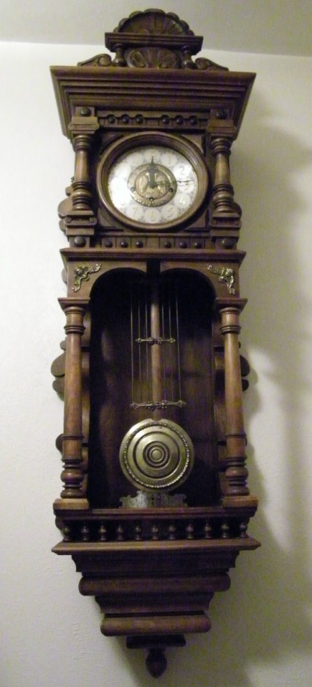

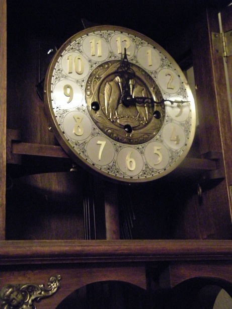

Mary Ann ScottThe last is a huge wall clock measuring about 5 feet tall. It was made by the Gazo Family Clock Factory sometime around 1974. I found online that they manufacture clocks with old world styling. I would like to know what type clock this is. There are several metal rods that strike something to create the tones. I call this one the rook because of the birds on the dial...
September 01, 2010, 23:48
Mary Ann ScottClose up showing the rooks on the dial...

Mary Ann ScottAnother showing the metal rods...

Tom BruntonThe clock "the Rooks" as you call it is called a "free swinger",many were made by the great German clockmakers of old. the grandfather has what is called "a rolling moon dial",and the wall clock is a Vienna regulator style clock.
