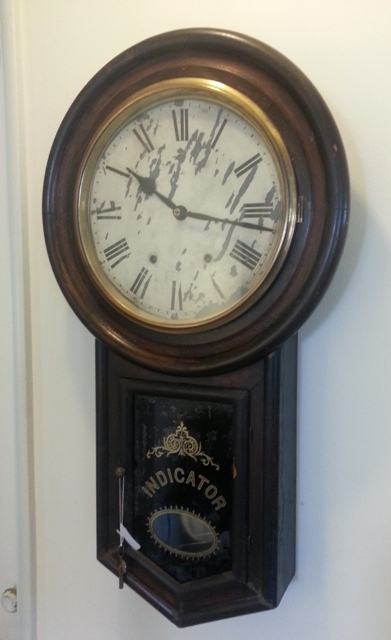

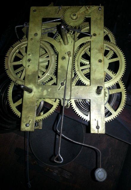

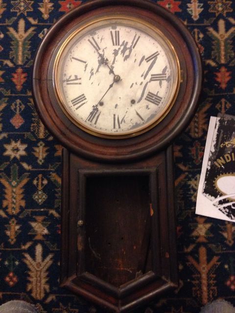

Dave in NC across this clock in my back yard.. I made a low ball offer and the guy took it. He came by the clock at a rural estate auction in Peoria Ill in 1977.
The bushings are tight and it looks like a coa and a chime spring will get her back up and running.
February 10, 2015, 02:15

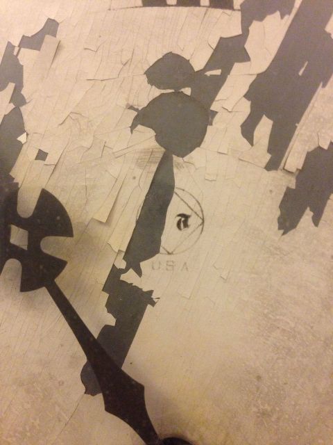

Paul D. TrombleyI reviewed some post here and am pretty sure this is a Seth Thomas logo on the dial.
Also mentioned that these clocks were real popular in the 1920's...were they residential, or business clocks?

John WillisI am not an expert on ST but have had a few. My impression is that this is not a ST. The only thing (in my limited experience with ST) that looks like ST is what remains of the marking on the dial. Some things that bother me about it are solid escape wheel. Lack of ID on plates and pinned plates. The hands are very much like some that Waterbury used and if the dial appears to be a non original I would be thinking Waterbury .I have not been able to find that case in my resources (limited) although Waterbury have some that are close.
What kind of wood is it Paul and is there any indication of non original dial or movement in that case?
I get the impression it is pretty old (pre 1890) and I sure like it. I think it will make a great project.

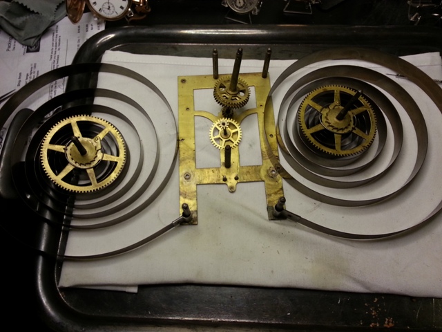

Paul D. TrombleyOK, So I'm a clock rookie! The springs attacked me when I pulled the top plate off even though they were let down all the way.
Now, they are two times larger than the hole they fit in to and I have no idea how I'm supposed to get them back in.
I did manage to find all the gears that scattered across the bench and put the thing back together minus the springs so I could understand how it all works.
Would one of you kind folks... when you recover from your laughter... please point me in the direction of a guide on how to manage these springs?
Seriously, I had no idea they would grow in to this!

Dave TurnerStill laughing! Confession is good for the soul.
Here's what I use to letdown the spring. Unfortunately my broom handle is now too short! And before that, I tie some wire around the spring to retain it within it's boundary in the frame.

Paul D. TrombleyIt's the whole "tie wire" thing I was missing the point on.
I reckon, to go back in, I will need to wind the spring on my bench winder, then put one of those heavy "C" shaped steel bands on it, so the tail will be accessible to drop over the corner post.

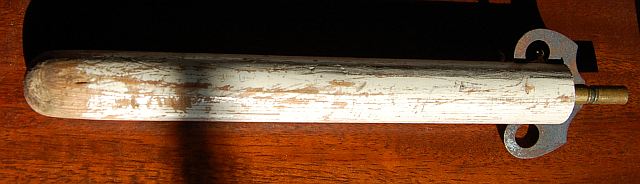

Paul D. TrombleyI was asked to add a photo of the pendulum. If you scroll up, you can see the pendulum spring/wire are a one piece design with a flat stirrup for this pendulum to hang in.
I think I'm missing the a bob... Based on some looking about in Timesavers and the picture below. I think there is supposed to be an 8oz bob on the end of the stick resting on the adjusting nut.

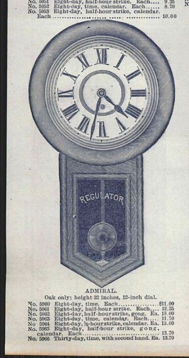

Paul D. TrombleyThis 1912 Waterbury advertisement is pretty close.

Bill CarlsonPaul,
Your lucky nothing happened worse that parts flying around. The springs look good. With out a spring winder, maybe you can somehow get the spring arbors back between the two plate without the gears and be able to wind up them backup and wrap a soft wire around them to keep them tight while you put the gears back. This is nice one to work on because of the size of the gears and open sides. You can get a bob from places like Timesavers, my favorite or others.It looks like the pendulum stick maybe patched, or maybe not. Good luck
This has been my favorite let-down tool. Or you can try the broom stick type if your not doing to many of these.

Paul D. TrombleyBill,
Thank you for chiming in. Sometimes the most intuitive answers are right there... and I just don't see them until they are pointed out.
I was trying to figure out how to modify the spring winder I bought for my Chelsea barrel springs to work for this installation.
Using the upper and lower plates to secure the springs and then proceed from there with the balance of the build makes a ton of sense.
I have new springs, a bob and a set of Ansonia hands that match the hands on the example in the advertisement above. Should be going back together this weekend.

Paul D. TrombleyI bought new springs from Timesavers, they came in brand new with wire and dropped right in once I figured out how to get the arbor in and hooked up.
The clock went back together great and runs well... with issues.
1. The pivot for the escape shifts left/right when it locks on either side... I'm assuming this means I need to replace the bushing for the upper escape pivot. Runs great, but looks scarey. I'm sure it isn't right. So far it isn't bad enough to affect the lock/unlock... but it is only a matter of time.
2. The pendulum oscillates weird. Sometimes it swings in almost a figure eight pattern rather than a clean left right... and other times it will pick up a wiggle like it is doing "The Queens Wave" as it swings to and fro. It still sounds good, just looks weird.
February 20, 2015, 15:25
John WillisPaul: I would suggest you check the suspension spring. From your picture it would appear to be the original one piece spring and rod. Check to ensure it is not twisted or kinked (happens often when clock is moved with pendulum left on). They can be worked a bit to straighten which often helps. If not a new replacement suspension spring should fix it. I like to keep the old one piece units if possible. Careful clocks are highly addictive

Paul D. TrombleyStill a mystery clock. Keeping excellent time!
I learned a couple lessons on timing. This clock came with a pendulum stick but no bob. I bought a bob from Timesavers and modified it to fit. 8oz seemed heavy, but the clock won't run with less than 6 oz... so 8oz is perfect.
The clock ran slow, so I lightened the bob up to 7oz and it made absolutely no difference. A quick google search landed me at abbeyclock.com
These kind folks have a great formula for plugging in my timing numbers and existing pendulum geometry... armed with these new numbers, I shortened the pendulum 1 inch and it came in to perfect time.

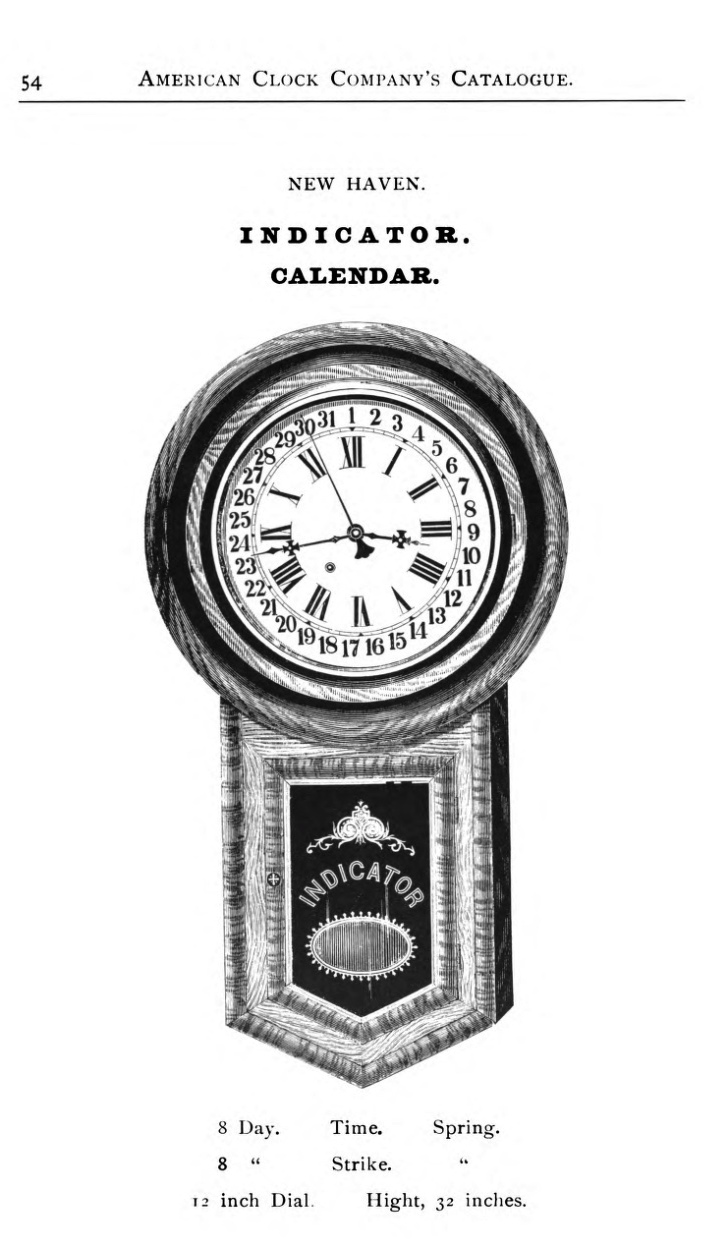

Lorne WasylishenPaul, this is from an 1878 clock catalogue.
February 24, 2015, 13:14
Lorne WasylishenI also found this which is also shown in the 1878 catalogue as a time only or time and strike with the same calendar dial as above.
Perhaps this dial was used later.
Does your clock have a place for the calendar hand? Perhaps they tossed it when the dial was changed to ST.
February 24, 2015, 14:34
Paul D. TrombleyLorne,
That's it! The wood bezel is a perfect match for my bezel with that groove.
No gearing or place for the calendar hand, so it is a simple time/strike.
Those hands are a perfect match too... so, off with the Ansonias and back to the Iron Crosses.
Just when I was losing interest in this one because I thought it might be a hopeless franken clock...
Now it is a simple matter of shopping for a period dial and I'm done.
How cool is that, thank you!

Lorne WasylishenDave pinned this clock as New Haven further up the hill, it was just a matter of finding it.
