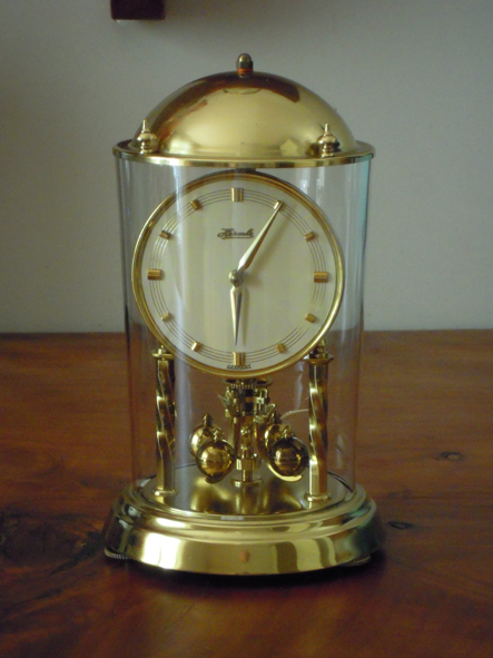

Hi friends,
herewith some pictures of my father's anniversary clock. After more o less 30 years I have refurbished my first clock and I'm now waiting for the new suspension. It was a very interesting job indeed.
Beppe

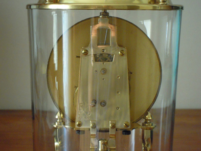

Giuseppe Crosta
Second picture

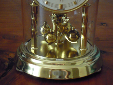

September 11, 2011, 11:29
Giuseppe Crosta
Third picture
September 12, 2011, 00:45
Michael Riska
Nice job Giuseppe. Very pretty clock! Mike
