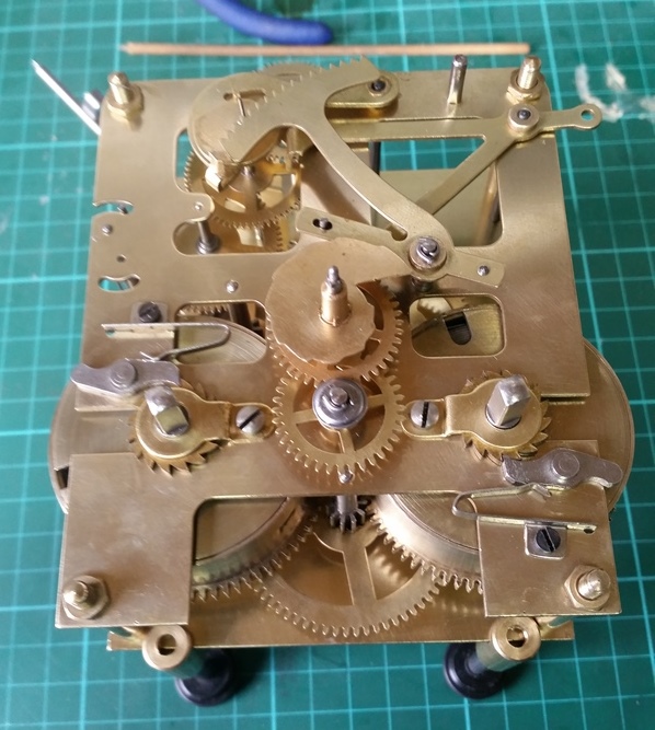

I am in the process of giving my sisters H.Samuel (Manchester) 8 day Mantle clock a full service.
I have cleaned, reassembled and oiled.
it's now on testing jig for regulating but straight away I have noticed that it is striking 3 minutes before the hour and half hour... The minute hand has a brass bush with square holed fitting...

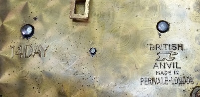

Bryan SkeenHi Dave,
The name on the movement is:
British Anvil
Made in PERIVALE LONDON
It's 14 day and not 8
I'll have to take a picture of the minute hand in the morning if you need it...

Bryan SkeenMakers Mark

Dave TurnerI'm still speculating here, but I'd say you might have the center wheel off one tooth or maybe two.
It would be easy to change and see.
You've done a fine job of cleaning! It looks good!

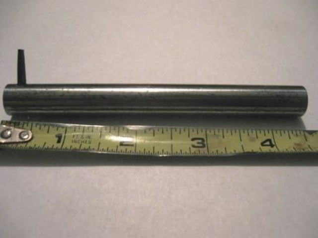

David E. Booth, Jr.If it was striking properly before you disassembled it, then it is almost certain you have one of the wheels off by a tooth or two. If, however, it has always struck either before or after the top of the hour, then the bushing in the minute hand needs to be adjusted. Here is a photo of a tool I made for that little job. I cross drilled a piece of 1/4" cold rolled bar stock, and drove a square "cut" nail through until it was tight. (Cut maails are hardened; you can't trim them with either nippers or a saw unless you have a carbide blade)I then ground the extra portion of the nail off flush with the bar stock. It fits everything from the smallest Hermle/Urgos movements up through Keininger and most of the Herschede minute hands.

Bryan SkeenAll sorted
Many thanks for your assistance guys...
By moving the minute wheel 2 teeth it has corrected the striking.
