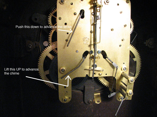

Tom SeymourPhil,
It should chime 4 notes on the quarter hour, 8 notes on the half hour, 12 notes on the 3/4 hour and 16 notes on the hour, and then strike the hours. If it is not chiming in that sequence, then it is out of sync. There are two levers on the back of the movement. One is for the hour strike and one is for the chime. The chime usually runs down before the strike train and the going train runs longer than the others. If you wait too long to rewind, the chime may have quit working. This will throw everything out of sync.
The Sonoras had no automatic syncing mechanism. You have to do it manually. I can send a picture to explain better if you like. It is sort of a pain to manually reset things, so I usually wind it twice a week, just to be sure everything stays as it should.

Tom SeymourTo adjust the chime and strike move the levers as indicated in the picture below. The chime movement has been removed for this picture to make it easier to see the levers.
June 27, 2006, 14:22
Phillip SanchezTom, piece of cake. Does that make me a full blown clockie as Bob suggests.
Hmmmm probably not. Thank you guys so much for your knowledge and assistance. Phil

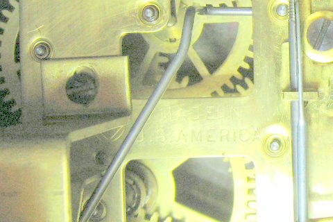

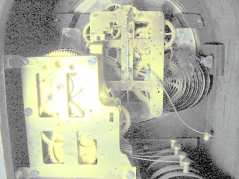

Phillip SanchezWell, pulled out the movements put the tiniest drop of oil in all of the little cuppie things
I could find. All of the chimes back in order it just won't strike the hour unless I do it manually. Something in there not pushing something else I presume. Still have a long way to go to become a true clockie.
July 26, 2006, 09:03
Tom SeymourGood effort Phillip! One of the things to check on a sonora is that the wires on the back of the main movment are on the corect side of the wires on the chime movement. It is tough to call without having it in hand, but that is a common problem with sonoras. The strike lever needs to be pushed down, so the activating lever on the chime movement needs to be above that lever. Very easy to have it go on the other side when putting it together.
