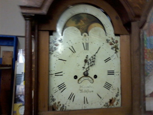

I am looking for a minute hand for this clock, a close friend of mine has asked me to do some minor repair for this clock.
It is a tall case grandfather clock we believe to have been made in the late 1700’s to the early 1800’s, there is the name Osborne on the dial.
The hour hand is 3 7/8 “ from hole to tip, we are assuming the minute hand would be about an inch longer.
Hoping someone her can help me,
Bill
October 22, 2018, 03:55
Bila WirriganwaltersWill be hard to find a loose one of those hands floating around Bill, might have to bite the bullet and make one to match the hour hand you still have, will take a lot of time to get right but very doable
November 10, 2018, 11:23
Michael RiskaBill, Timesavers has a similar hand set on page52 of their catalog. I used a set of these some years ago and they were pretty nice. They are stamped of course and don't show the depth of your original. They are 1.28mm thick so there is a little room for file work. The minute hand is different than the hour hand . Good Luck. Mike
