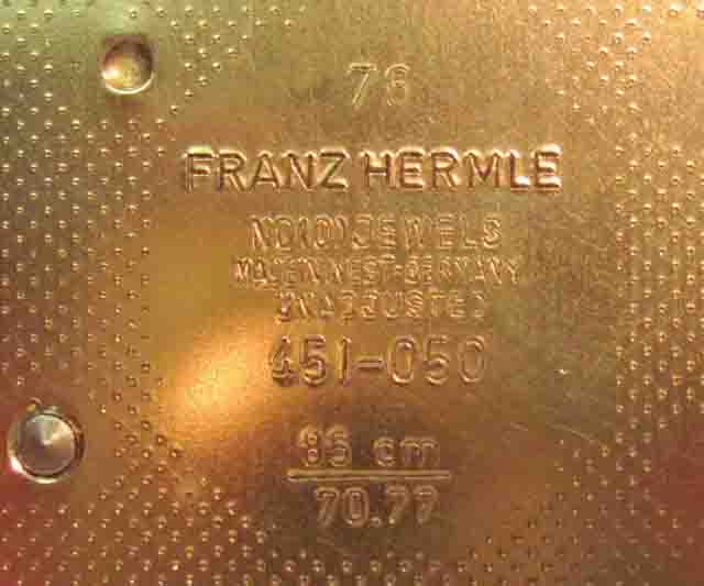

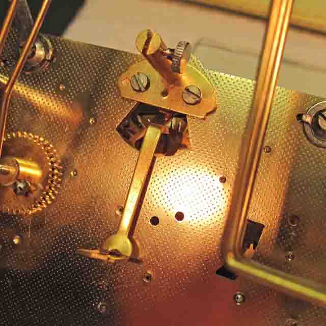

OK, I give up. I got this Hermle movement stamped 451-050 in a GM case. It was missing the pendulum leader and suspension spring along with some other problems. I rebuilt the movement and went to complete the escape and found the Hermle repair manual illustration did not match this unit. The escape movement was completely different. Not only that, but in this movement, the suspension bridge does not even line up with the escape crutch slots. Any thoughts? This was made in 1976, and I doubt there have been any model changes. This one has me puzzled. I need to know what suspension spring to use, what the pendulum leader looks like, and how they work together as they don’t line up.

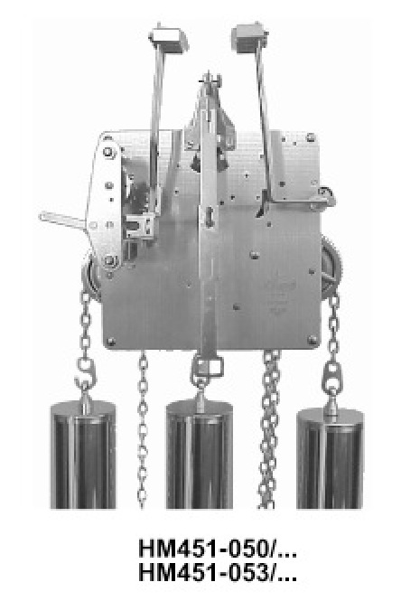

Bill CarlsonHi Ken,
Here is an image of your clock that may give you an idea of what is missing. This from Black Forest Imports. This is an excellent source for parts also.

Ken KnightBill, That is the puzzlement, the image you show from Black Forest, is the same as in my repair manual. However the escape is not the same, nor can I mount the overhead suspension spring support on it, as it is also attached to the front plate and there are no screw holes in it for that attachment.

Bill CarlsonI see what your talking about! I see the verge must be high in the one photo, but not on yours. I can see the escape wheel is low and wouldn't work.
