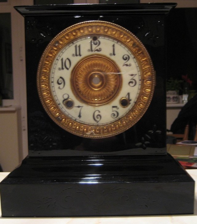

I've had this cast iron Ansonia for many years. I believe it to be an 'Unique' The case had a chunk out of it, I fixed that and sprayed it black.The case is now presentable and the dial is fine.
But the movement is the problem, it is a wreck teeth bent, pivot holes show enormous wear , parts missing etc. Its labelled 51/2, what does this mean, have I chance of finding another in good condition, are replacements available?
All opinions welcome.
Photos of the movement available, but they would make you cry.

I don't think it will be too hard to find. I have some movements, but at the moment they are packed away in storage, as we prepare to sell this house and make our move out west. If you don't have find a replacement by the time we are settled in to the new place, I will be happy to look through my stach to see if there is a match.
You might think about buying a junker case with a decent movement in it. They show up fairly frequently so I think your work on the case will soon be completed with a nice movement.

As I recall, on some models that is pendulum lenght. Anyone with different info please jump in here.

Peter, the 5 1/2 IS the pendulum length. That particular clock sells for anywhere from $150. to $200. in my area, Pa. U.S.

Peter, I have found that most of the Ansonia movements that have the same shape plates and pendulum length have interchangeable parts.
